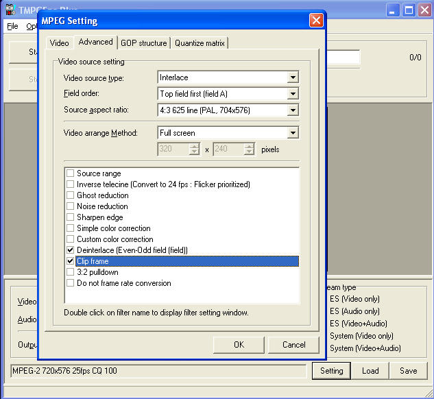

I've recorded video from the high definition channels using a 4:3 Hauppauge card. Now I have video with black bars actually recorded into the video. What is the best tool to remove these bars so I can view the video properly on a native widescreen display?

You need to close the wizard and import the m2v file then open the settings after demuxing.
But you need to know what each setting need's to be set at manually because it won't do it for you.
