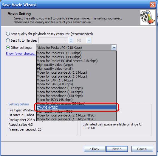

Skydiver6, not a fan of WMM, but it does have a 'hidden' feature.
It can output in DV-AVI format that many encoders and editors can accept and it is fairly low loss, low compression. When you go to save your video, select 'Other settings' and scroll down to DV-AVI.
DV uses about 13GB per hour of video, so make sure you have enough space. -

I would skip WMM entirely, but the OP mentioned it. DV-AVI is the best output option for it, IMO, if you really want to use the program and you want to end up with a DVD format. But you are correct, it's always better to edit in the native format whenever possible. There are a few freeware MPEG editors, Cuttermaran is the first that comes to mind. I would rather use VideoReDo or MPG-VCR or other payware editors.
DV is low loss (Or more correct, low compression, about 5:1) compared to some other formats, but going from MPEG-2 to DV, then back to MPEG-2 will give you quite a noticeable quality loss, depending on your original formats quality.
