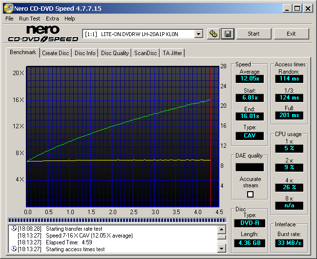

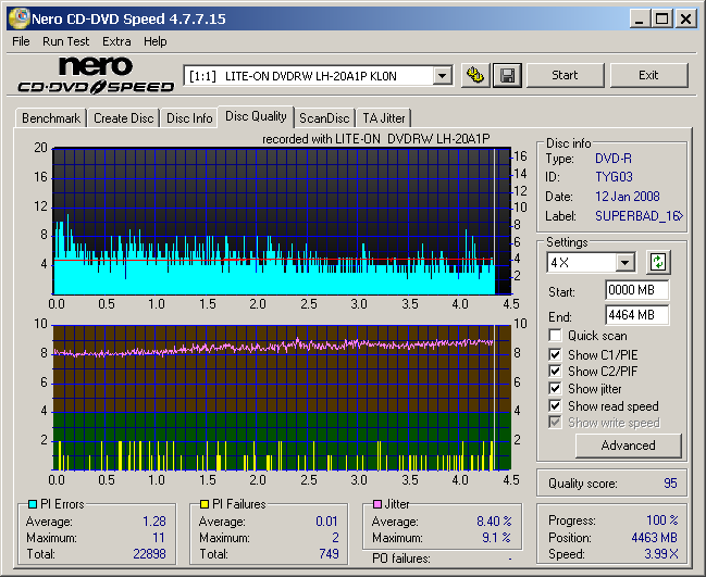

    According to my tests with LG GSA-H55N and Lite-On LH-20A1P burners, using Taiyo Yuden DVD-R 16x TYG03 and Verbatim DVD+R 16x MCC004 media, my best burn to date is at 16x speed with TYG03 using the Lite-On drive (see attached graphic). There may be other drives capable of burning slow with good results, but these two drives are not among them! So the new rule of thumb seems to be: when in doubt burn fast (not slow)
