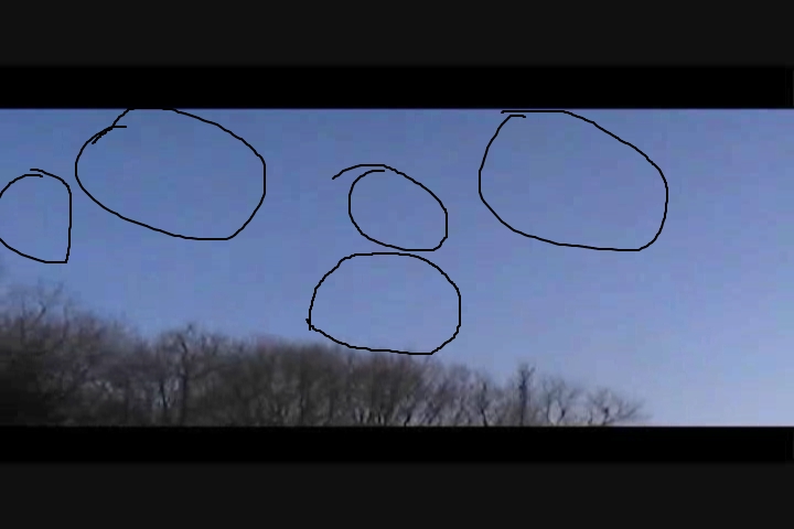

Just wondering what the distortion is called and if I can fix it but I don't know how to search images. I thought they were DV artefacts but that only got me more confused.

looks like blocking from a low bitrate...
blurry trees, too -
You can smooth it out and make it look 10 times worse.
Other than that, no, you can't fix it. -

That's pixelization. Usually occurs during fast camera movement or video files with bit rates that are too low to keep up with the rate the screen is changing.Originally Posted by sithguy
I have to disagreeOriginally Posted by z0diac
It looks much more like banding which occurs on regions of the video that have little detail and are of a similar color. It arises due to low bit rate compression.

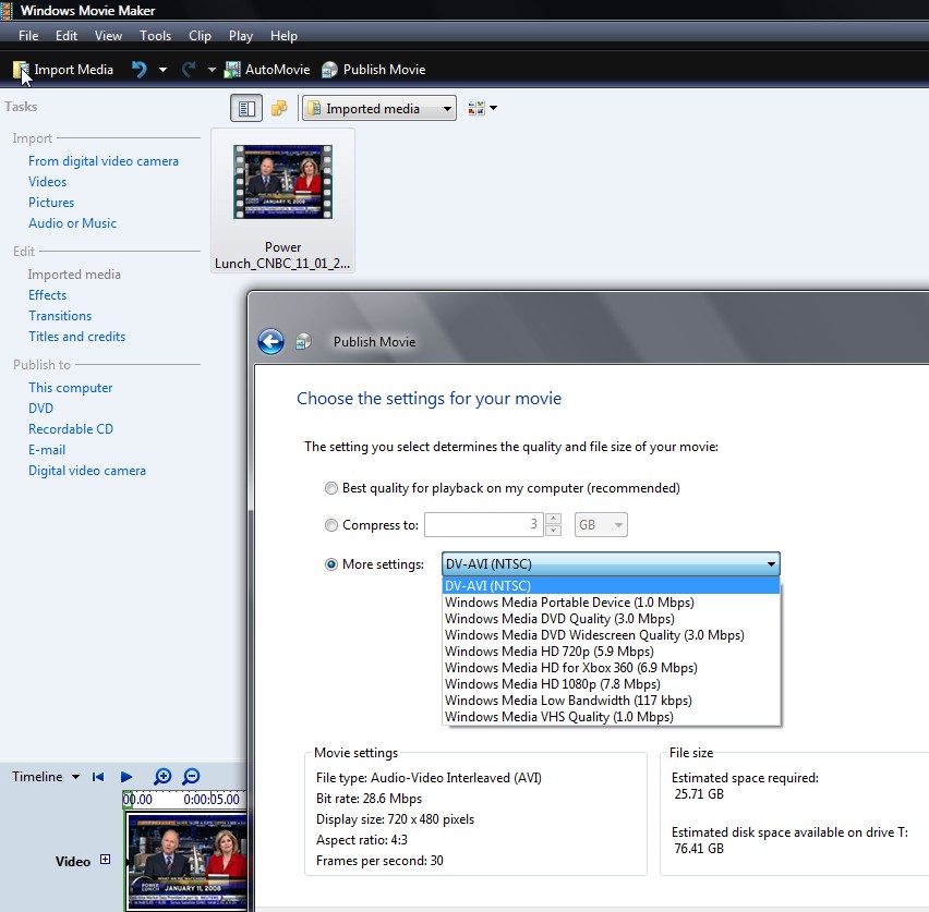

From the way things have been described, the original DV material was captured via WMM to WMV format rather than keeping it as DV format. -
Those were my thoughts too. Windows Movie maker imports DV properly. When you export, use DV-AVI in "More Settings". XP WMM is similar but DV-AVI is further down the list.Originally Posted by JohnnyMalaria
Next use your MPeg2 encoder of choice and author the DVD.
