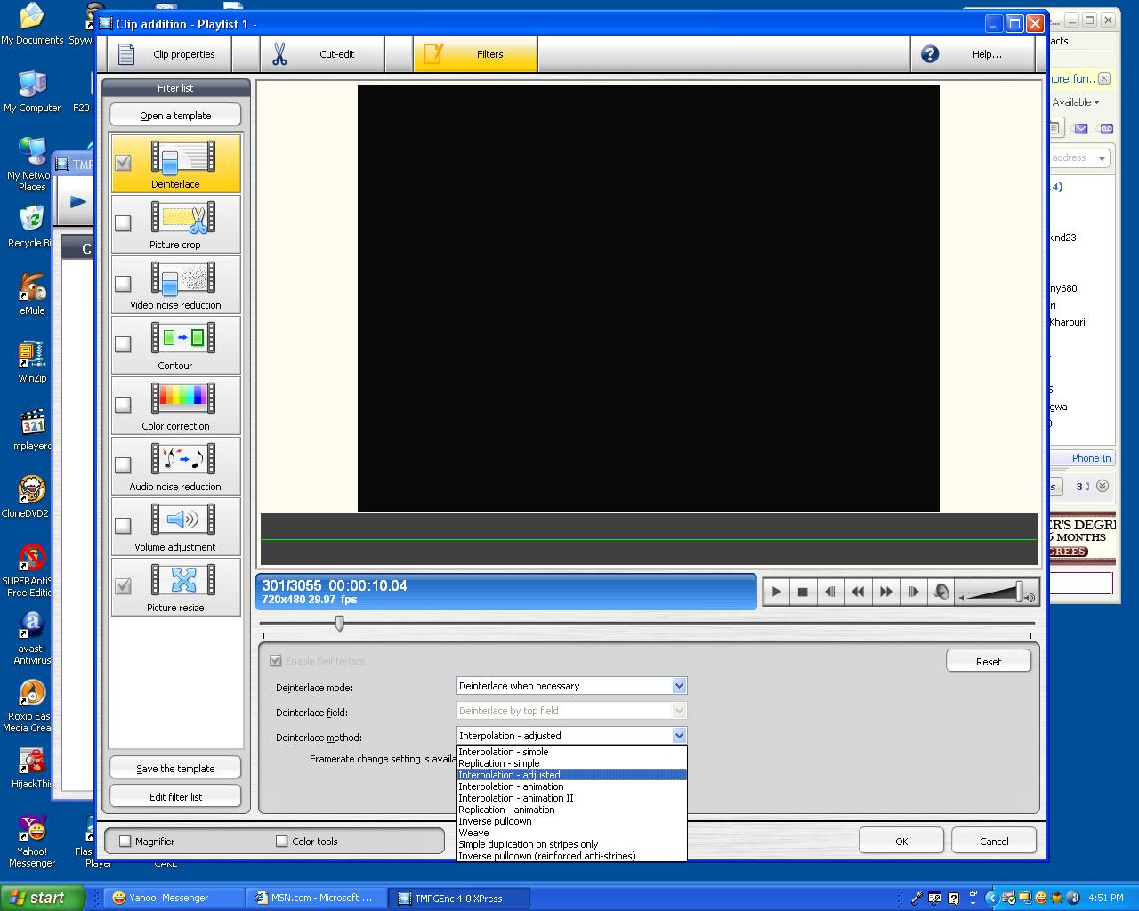

Hello, I record shows onto my DVD+RW in SP mode, then transfer for them onto my HDD to convert to DIVX.
The program I use is Tempeg Xpress 4.4 (Pegasys software).
I use Comcast cable, and all the channels including the channels beloew 100 are standard definition digital. No analog.
B/C the channels are digital, there are compression artifacts, but they are not that bad.
Here is the problem:
I load the DVD video I want to convert.
I select DIVX as the codec I want to use.
The bitrate I use is 1000 kb/s.
I select 2-pass conversion (motion is set at 0)
I select 29.29 fps w/interlace
I select extreme quality.
When I finish converting, I burn the Divx files to disc and view them on my TV. The finished product is crap. The images whether they are moving or not are blocly and heavily pixelated?
WHy is this? Are my settings wrong? My TV is a good ol fashion tube TV.
I play them back on my Liteon 5115 and Philips 642, same dissapointing results.
ANy tips or help be be appreciated. Thanks for your time.
Oh, the reason I use tempeg express 4.4 is b/c I can easily edit out the segments I don't need.

You didn't mention how the files on the DVD+RW look. Play this disc back too. Remember, you are doing 3 compressions here, from compressed digital cable to compressed mpeg2 (DVD+RW) and compressing yet again to avi. There will be quality loss.
2 things that will greatly improve the quality, 1st. deinterlace/IVTC the video, 2nd resize it down to something like 512x384 or 624x432. As Baldrick suggested, AutoGK will do a fabulous job at this.

Interlaced video and Divx don't mix well. -
Ohh, I have a noob question:
WHy do I need to de-interlace the video when I'm going to watch these on TV and the TV is interlaced anyway. -
Your files may not be interlaced but telecined. Divx/xvid is not an interlace happy format like mpeg2.

I don't use TMPGEnc Express. But, if the source was film, the "inverse pulldown" options should work best. On the other hand, inverse telecine can be hard to do well so it may give you jerky results or let lots of interlaced frames through.
That was how it was delivered to you. The question is what was the original source? Was it a movie shot on film, a live sporting event, something else? A movie can usually be inverse telecined back to the original film frames. A live sporting event will be fully interlaced and will call for different deinterlacing techniques.Originally Posted by peggypwr1

Try increasing the bitrate to 3000 kbit/s. In my experience divx/xvid gives about equal quality at half the bitrate of MPEG-2 when using the same resolution. Interlaced DVD looks fine at around 6 Mbit/s so my guess is that interlaced divx would require something like 3 Mbit/s. However your standalone player may not play interlaced divx very well. Test it and see if it works.
Well this is interesting:
When I used Tempeg Xpress's Divx encoder my DIVX files came out horrible, wven at 2000 bitrate on two-pass.
BUT:
When I used the stand alone DIVX 6.8, on one-pass at 2000 bit rate, the DIVX files looked almost like the ones on the DVD! -
