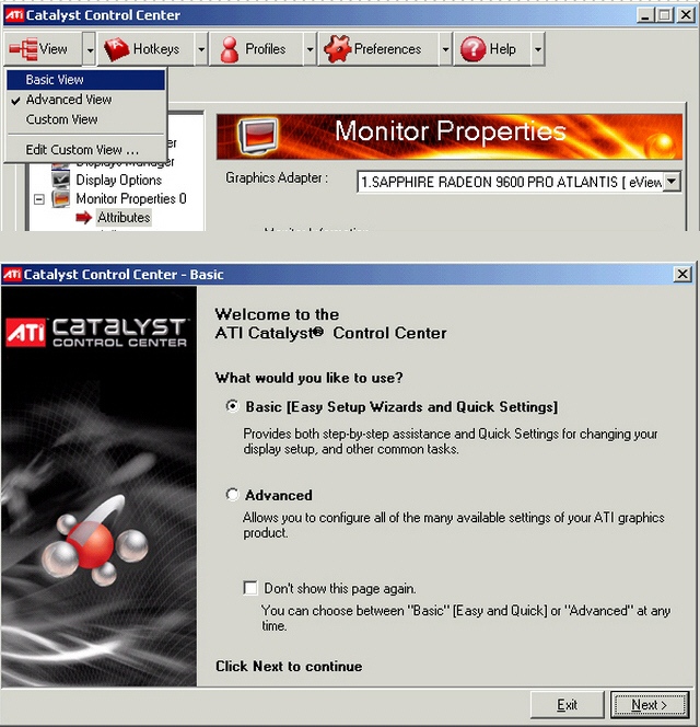

    Sounds like your in the advance mode, you may try switching to the basic mode.
    Click next and that should walk you through.

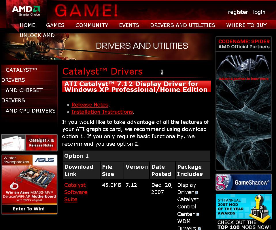

  9. i when't to ati and found this ,but i am not to sure if this is the right thing.I haven't removed drivers and then installed new ones. can you give me some info on this, THANKS
    Aug 2007
    That appears to be ATI's most recent driver package for the 9550 running on 32bit XP. I would encourage you to read through and understand their installation instructions. If you are the least bit uncomfortable with installing and or updating your drivers you may wish to consult the vendor that supplied you with your 9550.

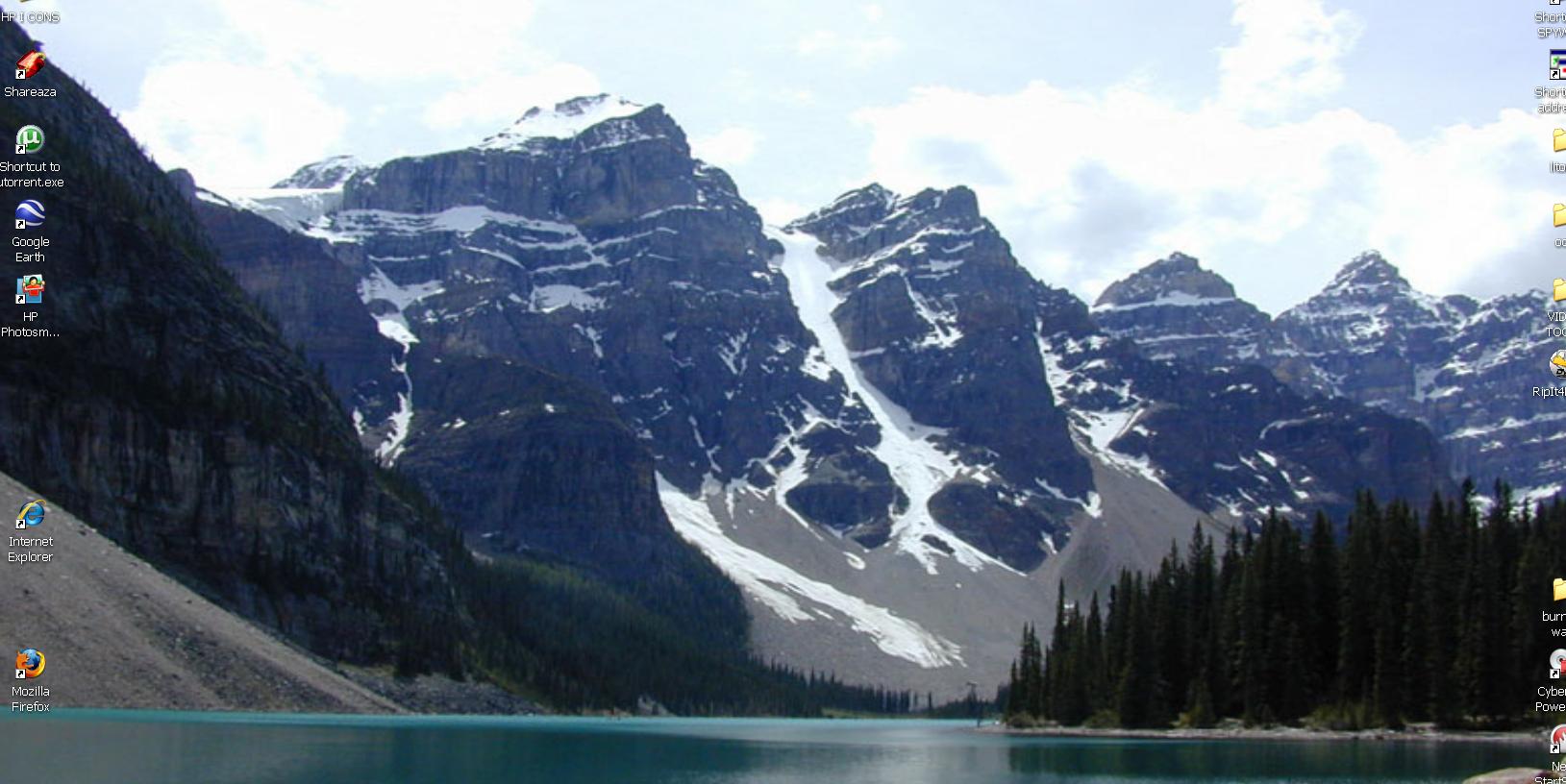

  11. I downloaded catalyst control center ran the wizards. DL. option 1 got them installed.Cleck on extended desktop, tv as 2nd monitor, now it shows my desk top as shown below.but i can't get it to do any thing more.must be some thing i still must do, can you help with this.Thanks for helping me with this, bill

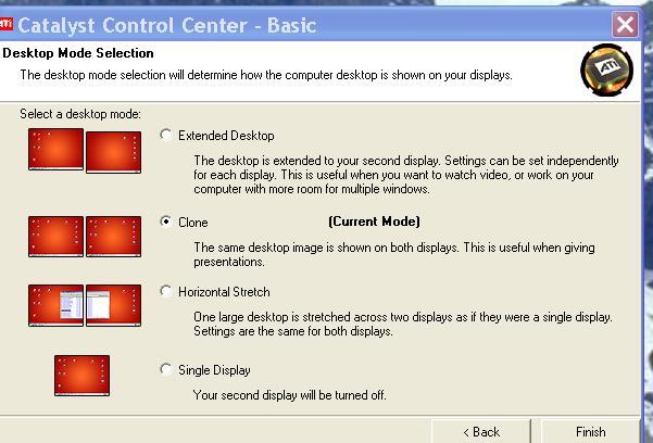

    Right click on your desktop. Open ATI Catalyst Control Center. Go through the Easy Setup Wizard
    When you get to the Desktop Mode Selection screen - Select "Clone" - You should now see your desktop on your TV.

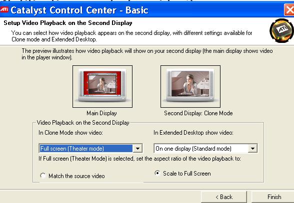

  13. i went from extended desktop to clone, now what ever apps i clic on show up on the tv.Getting closer, but i can;t get vedeo to show on tv.i put in a dvd it showed the player on the tv and was playing but no video.Can it be in the resolution?
    Aug 2007
    Nice work Bill, now your getting the hang of it.

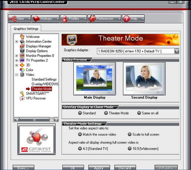

    Now go into advanced mode and get your settings to look something like this
  15. I did the above and i now have video. Thank you so much for the help and your time.

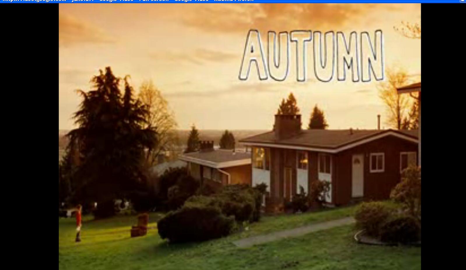

  16. new problem ,yesterday i had a full screen on my dks,top and picture was good on tv, now both seem to be in 4.3 .i have a wide screen pc,lcd.i can't find any aspect ratio in catalyst settings or in my monitor. with your pict.above i can see it but not in mine,.i hope you can help me ,
  17. this one shows what i have
  18. Member
    Aug 2007
    You gotta work with me here. Put a check in "Match the source video"
  19. i checked match the source video,it seems the same.I am in clone mode.In extended desk top all i get is the pict of my desk top above but no video ,but it seams that is what i should use so you can set each monitor independently.when i go o full screen on some videos the screen will roll.
