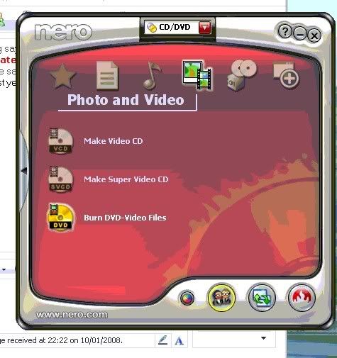

    I have got NERO startsmart essentials, that came with my DVD burner. But when i am trying to BURN DVD VIDEO FILES using it i get this error message.
    I have created the VIDEO_TS and AUDIO_TS files using shrink, but NERO wont let me burn them. Has anyone got this version of NERO and can anyone offer me any help. As i dont understand what the error message is telling me in selecting another "compilation type" and o cant find any settings that i can relate to this message

    Did you choose DVD-VIDEO compilation in NERO?
    Dec 2002
    i choose this option " BURN DVD VIDEO FILES"
    im used to using RNMAX 4.5, but this new burner isnt supported by RNMAX 4.5 so thats why im using NERO,

    That seems to be the correct compilation. How do you author or create the video files? DB83 said it right that the files can't be bigger that 1 gig. Can you show us a screen capture of the files in View All detail mode from your explorer window? It might help us troubleshooting.
