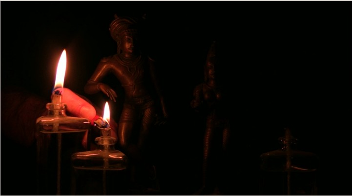

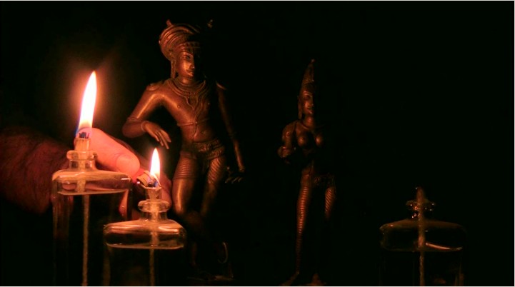

Just making a note to myself about suggested settings for dark backgrounds.
HDRAGC(coef_gain=1.5,coef_sat=0.8,min_gain=1.5,avg _window=1,corrector=.7)
You can bring a lot of detail out of the darker areas, within reason.
Original
Enhanced

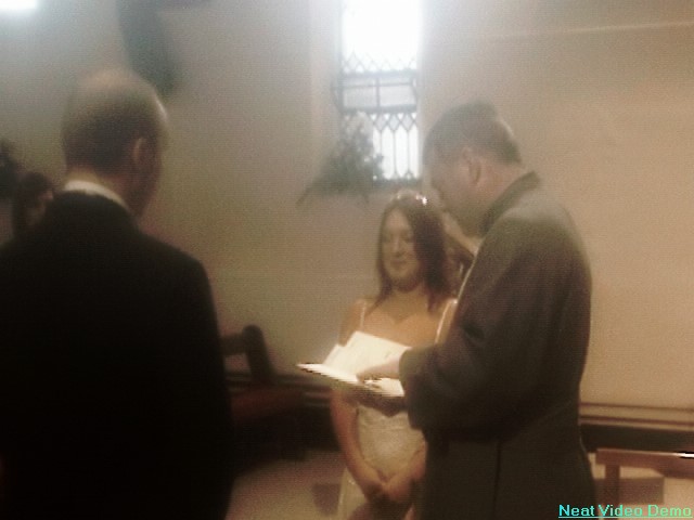

Had a little try at it with combinations of fft3dfilter, DeGrainMedian, mvdenoise2, hdragc, limitedsharpenfaster. All turn out to lose too much detail for my liking. Post a query over at Doom9 in the avisynth usage forum and hope a master like scharfis_brain or Didee and many others has a look... they do absolute wonders. Of three tries I think the least fuzzy is the bottom one (all frame 187 of clip1):-
VirtualDub: cropped to 640x480 (the Neat Video demo won't work over 640x480), S shaped gradation curve to bring out a little detail in the mid tones without blowing out dark and light areas, Neat Video, a little saturation reduction:
It could use more work (and I ignored the fact that the video was interlaced) but this should give you some ideas. I tend toward less noise reduction than most others here.
