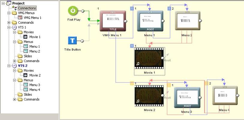

    I want 2 movies on one DVD. Each is selectable from the first menu (VMG ?), then each with a separate title menu and a chapter menu See the jpg's here.
    I get a pre verification error when I go to Compile it.
    In my Project, Menu 1 for Movie 1 contains buttons Play and Select scenes; Menu 2 has the chapters for Movie 1;
    Menu 3 for Movie 2 contains buttons for Play and Select scenes; Menu 4 has the Chapters for Movie 2.

    A question / tip. Do you want your video to play through from movie 1 to movie 2? If you don't want it to play through, no problem as it is now. If you do want it to play through, you can draw a link from movie 1 to movie 2 in the navigation view. This won't affect your menu functionality; it will just cause the movie to play through from movie 1 to movie 2 when you watch it from the beginning.
