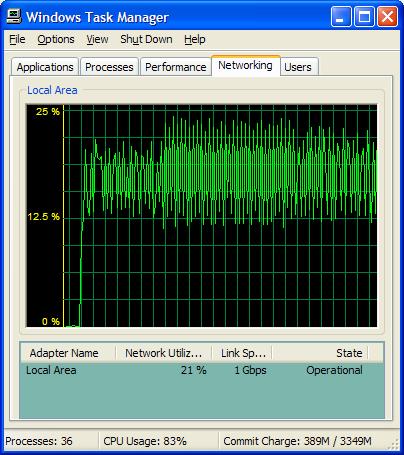

I use all CAT6 for my 20M runs. Some CAT5 for the shorter 1 - 2M cables. Most all cables these days are CAT5 or better. There is also a CAT5E for enhanced. If you get anything through the switch, it's working with your cables. Mine does auto negotiate if I were to use a crossover cable.
Just for the record, I have never got my Gigabit LAN system to perform a fast as I would like, but it's faster than a 10/100, so I just live with it.
I have no problems viewing HD video over it, but file transfer could be a lot faster. It transfers about 17MB a second with about 20% network utilization.
You might also check with your NIC manufactures and see if they have updated drivers. -
