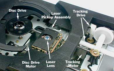

    If it gets a lot of use, it may be time for replacement.
    You can try a more intense cleaning with some damp Q-tips and isopropyl alcohol (90%) and see if there is any gunk on the laser lens. If that doesn't do it, I would consider shopping for a new unit.
    That's from a CD player, but a DVD player/burner is very similar.

    Thanks, Red. I hate to crack it open, but I suppose I (theoretically) can't make it any worse.

    You 'may' be able to see the lens if the tray is open. (Assuming it's a tray loader) Worth a try. It would be nice to spot something on it, then there may be a better hope of a simple cleaning fix. But you're right, at some point, you have little to lose.

    If you manage to open it up to see the laser, try a little dab (just enough to moisten) (on a Q tip) of ammonia..I think that's how it's spelled???
