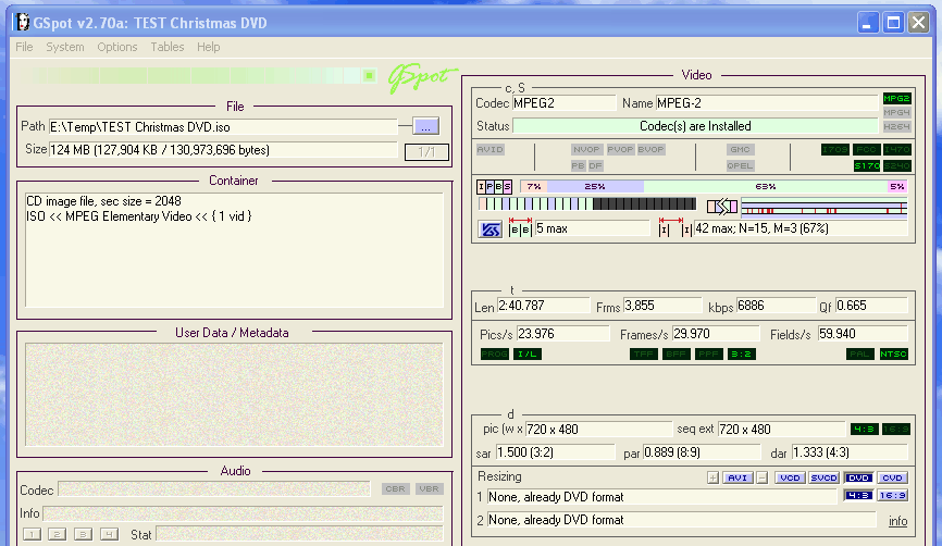

I have no idea what most of the data means in the attached screen shot captured from GSpot, but maybe some of you will see something interesting?

UPDATE: So I decided to re-encode an ISO using the Avid Liquid built-in encoder and voila! the video works as expected on three different DVD player/TV combos. I don't understand all that is different, but here is the revised GSpot output that shows a different PAR or .9 instead of 1.2 and the DAR is 4:3 rather than 16:9. But it works
Can you help me understand what is going on with the two? Thanks!
If is was to take a wild guess, the content of the ISO will be an authored DVD, whereas your original file was just an mpeg-2 file. If this is the case, you should be able to just author your video without re-encoding and get correct playback.
