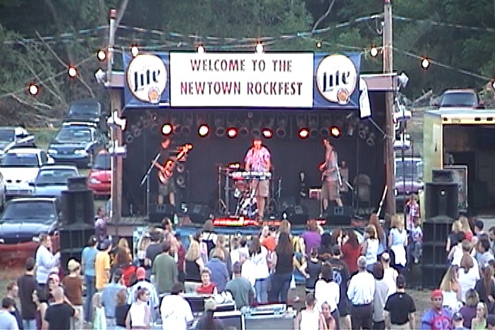

DV is a set resolution of 720 X 480(576 for PAL) whether 16:9 or 4:3.
16:9 DV screenshot where it hasn't been adjusted for aspect:
You encode and author this as 16:9, the resolution does not change for standard DVD, the DVD player sees the 16:9 flag and adjusts the aspect by adding black bars top and bottom if you're viewing on a 4:3 TV or stretches it out to full screen for playback on a 16:9 TV. -
