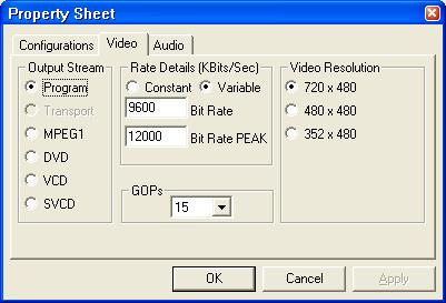

The one that's not marked as CBR is an auto VBR mode. It will make smaller files because it uses a lower bitrate when it the full 12000 kbps isn't needed (for example a half second of all black between a show and a commericial can use a much lower bitrate). It shoots for a 9600 kbps average with 12000 kbps peaks. From WinTV2000 use Pref -> Movies -> Advanced and you'll see:
For even better caps, you can also create your own template with up to 15,000 kbps, CBR or VBR. -
