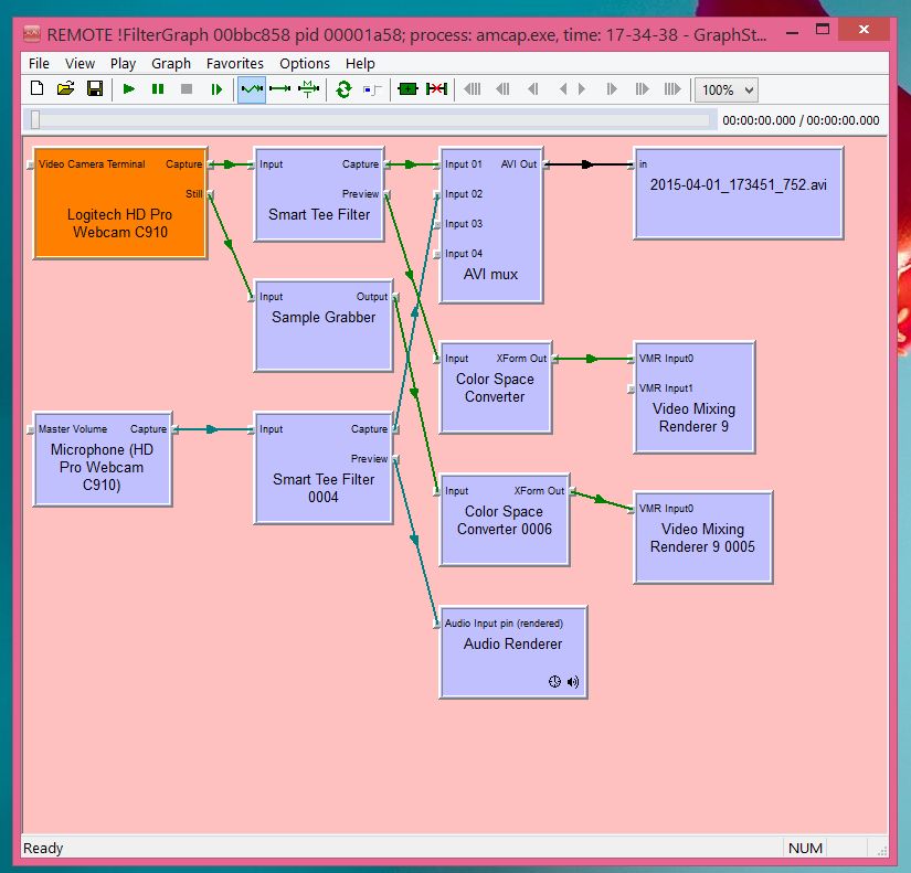

Name:	C910 AMCap Uncompressed Video & Still Capture & Recording Graph.jpg
  5. This command was reported to work for Logitech C910 and other webcams including laptop integrated, when capturing natively compressed MGPEG & PCM webcam stream to mkv without transcoding, and using Preview window:
    ffmpeg -s 1280x720 -framerate 30 -c:v mjpeg -c:a pcm_s16le -rtbufsize 100MB -f dshow -i video="Logitech HD Pro Webcam C910":audio="Microphone (HD Pro Webcam C910)" -flags +global_header -c copy -copytb 1 -f tee -map 0:v -map 0:a "L:\\Video\\C910.mkv|[f=matroska]udp://192.168.3.35:1234/" | ffplay -f matroska udp://192.168.3.35:1234/
    It works for me, resulting in 3-4 sec output delay in Preview and some extra CPU load. VirtualDub shows twice lower CPU load during capture with preview, but its remote graph shows only preview mode, hence recording is done by some direct calls to lib.

    Originally Posted by zamar27 View Post
    This command was reported to work for my webcam, when capturing natively compressed MGPEG & PCM webcam stream to mkv without transcoding, and using Preview window:
    It does for me, resulting in 3-4 sec video delay in Preview and some extra CPU load.
    OK, thanks! I'll have a look.
    I did some experiments with audio only capture. I'm currently on a single core machine without video capture card. I only did the FFplay preview so no simultaneous FFmpeg encoding and had already almost one second delay. I have a quad-core machine with a video capture card and probably try some things out with that in the weekend. I don't have a webcam.
    Chris
