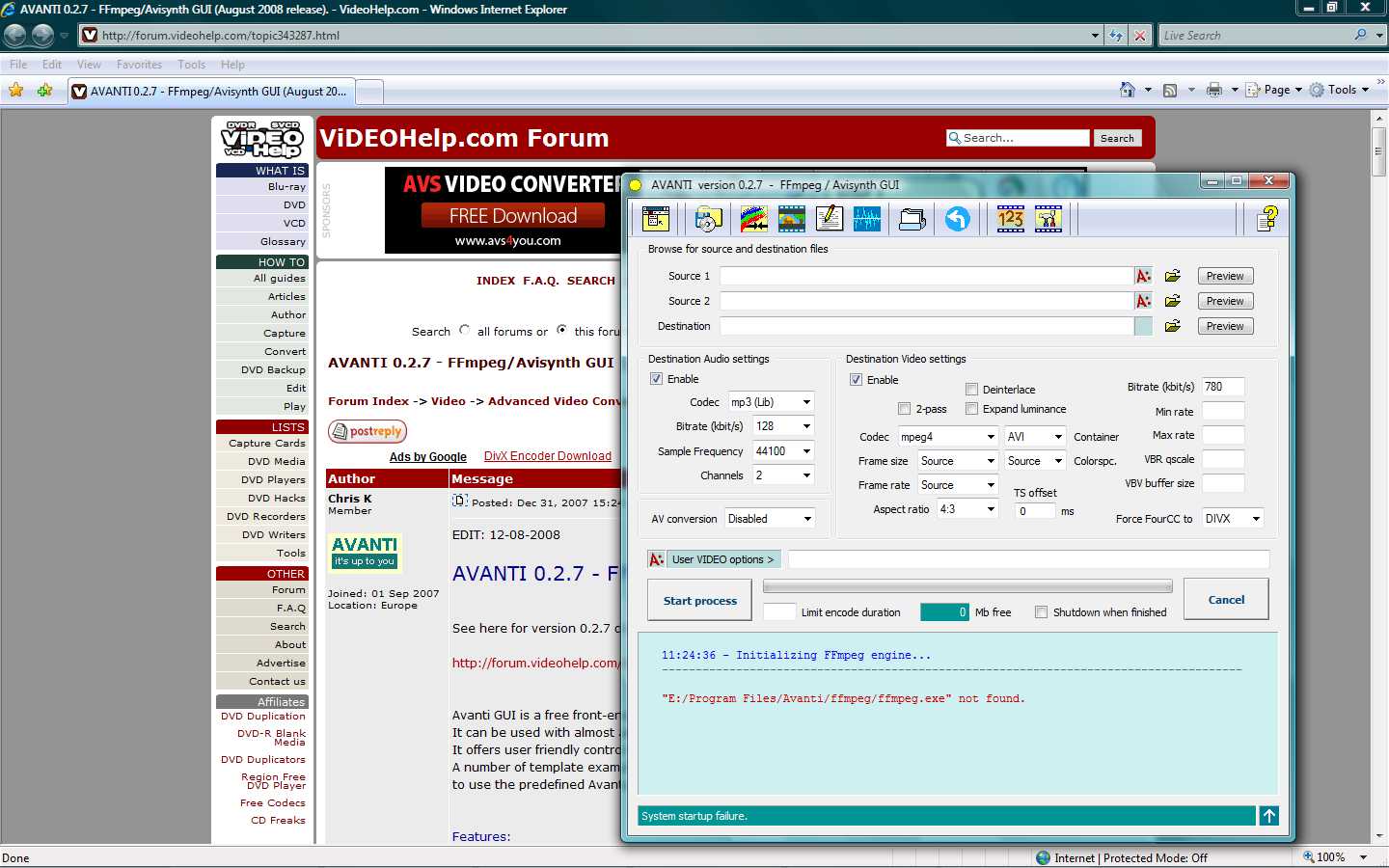

    Hi to all,
    AVANTI 0.2.7 - FFmpeg/Avisynth GUI (August 2008 release) available.
    This version has the following changes:
    ..1.. Added copy audio/video (flexible alternative for mux/demux).
    ..2.. Added options manager (to re-organize user additions).
    ..3.. Added dedicated template load/save dialogs.
    ..4.. Added TAGS to template files (long names/sorting/comment).
    ..5.. Added/improved template examples (ipod, psp, etc.).
    ..6.. Improved template comment management (dedicated editor).
    ..7.. Added check to prevent accidental exit during process.
    ..8.. Made FFmpeg crop/scale/pad available in Avisynth user mode.
    ..9.. Improved accuracy of frame size calculator.
    .10.. Fixed path bug with startup from desktop shortcut (WXP).
    .11.. Fixed bug in user mapping when using 2-pass encoding.
    .12.. Fixed bug in ".user" extension (still had restrictions).
    .13.. Fixed bug in Avisynth segmented source support.
    .14.. Fixed bug in Avisynth path labels (@plugins/@superEQ).
    .15.. Fixed bug in "Advanced database manager".
    .16.. Updated codecs/formats database (new codecs/descriptions).
    .17.. Updated chm help for additions and changes.
    I'm very happy to announce that Avanti has found its home at:
    http://avanti.arrozcru.com
    You can download Avanti 0.2.7 and some previous releases from there
    and find all other FFmpeg/Avanti related links you may need.
    Many thanks go out to Ramiro Polla for hosting Avanti and for keeping up
    the most versatile and informative site on building your own FFmpeg
    for the Windows OS or downloading ready to use Win32 builds.
    http://arrozcru.no-ip.org/ffmpeg
    Also to 45tripp for continuing his advice and suggestions for Avanti
    and for keeping the FFmpeg Win32 builds up-to-date.

  30. Member
    Aug 2008
    Hi, I am sub-newbie so please excuse me if this is a dumb question. On starting up Avanti I keep on getting message "ffmpeg.exe not found". I have put ffmeg.exe version 14623 in the folder as you can see from the images. I don't understand what is going wrong. Thanks.
