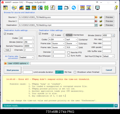

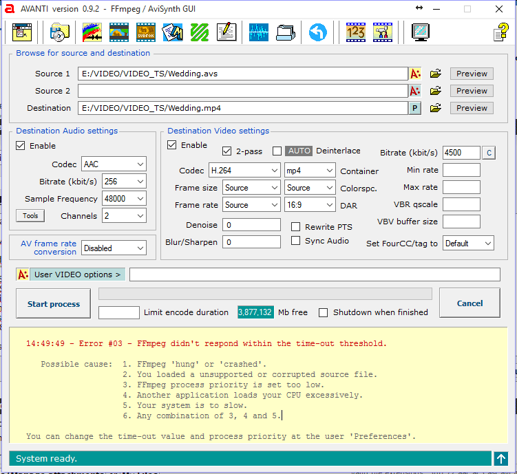

    I'm using Avanti 0.9.2 to convert my son's wedding video from DVD. I wrote an AVISynth script as the source:
    LoadPlugin("C:\Program Files (x86)\dgmpgdec158\dgdecode.dll")
    LoadPlugin("C:\Program Files (x86)\AviSynth\plugins\SmoothDeinterlacer.dll")
    vid=MPEG2Source("E:\VIDEO\VIDEO_TS\Wedding.d2v", cpu=0)
    audio=WAVSource("E:\VIDEO\VIDEO_TS\Wedding T80 2_0ch 256Kbps 48KHz.wav")
    AudioDub(vid,audio)
    SmoothDeinterlace(lacethresh = 5, tff = true, doublerate = true, edgethresh = 10, showlace = false)
    Lanczos4resize(854,480)
    Crop(6, 4, -8, -0)
    Alas, at some point, probably in the second pass (I'm not watching all the time) it gives me this:
    and there's a zero-byte file. I'm using ffmpeg-20150831-git-1acd631-win32-static. The log, severely trimmed, is:
    #options: 840x476 fps=60000/1001 timebase=1001/60000 bitdepth=8 cabac=1 ref=1 deblock=1:0:0 analyse=0x1:0 me=dia subme=2 psy=1 psy_rd=1.00:0.00 mixed_ref=0 me_range=16 chroma_me=1 trellis=0 8x8dct=0 cqm=0 deadzone=21,11 fast_pskip=1 chroma_qp_offset=0 threads=8 lookahead_threads=2 sliced_threads=0 nr=0 decimate=1 interlaced=0 bluray_compat=0 constrained_intra=0 bframes=3 b_pyramid=2 b_adapt=1 b_bias=0 direct=1 weightb=1 open_gop=0 weightp=2 keyint=250 keyint_min=25 scenecut=40 intra_refresh=0 rc_lookahead=40 rc=abr mbtree=1 bitrate=4500 ratetol=1.0 qcomp=0.60 qpmin=0 qpmax=69 qpstep=4 ip_ratio=1.40 aq=1:1.00
    in:0 out:0 type:I dur:2 cpbdur:2 q:27.80 aq:8.00 tex:264 mv:529 misc:103 imb:1590 pmb:0 smb:0 d:- ref:;
    in:4 out:1 type:P dur:2 cpbdur:2 q:27.80 aq:8.00 tex:0 mv:0 misc:184 imb:0 pmb:0 smb:1590 d:- ref:0 ;
    in:425522 out:425524 type:b dur:2 cpbdur:2 q:24.14 aq:9.00 tex:0 mv:0 misc:160 imb:0 pmb:0 smb:1590 d:- ref:0 ;
    in:425524 out:425525 type:b dur:2 cpbdur:2 q:24.14 aq:9.00 tex:0 mv:0 misc:160 imb:0 pmb:0 smb:1590 d:- ref:0 ;
    Sep 2007
    Europe
    The default time-out for FFmpeg is set to 20 seconds. It might be possible that initializing the AviSynth script takes more time. You can increase the time-out at the "User Preferences" (top left main menu). Try something like 60 seconds.
    If I use the H.264 preset with a birate of 4500 kbps, I get this FFmpeg warning at the second pass ...
    -> [libx264 @ 03259420] Error: 2pass curve failed to converge
    -> [libx264 @ 03259420] target: 4500.00 kbit/s, expected: 2622.13 kbit/s, avg QP: 10.0008
    -> [libx264 @ 03259420] try reducing target bitrate or reducing qp_min (currently 10)
    If you want to keep this bitrate, you can remove the -qmin 10 command at the FFmpeg script.
    It probably has nothing to do with it but ffmpeg-20150831-git-1acd631 crashes for me (Win XP). I'm not able to test on Win 10. The latest I used is ffmpeg-20150814-git-affbecb from Zeranoe (archive date August 13).
    http://ffmpeg.zeranoe.com/builds/win32/static/
    Chris
