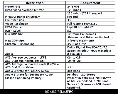

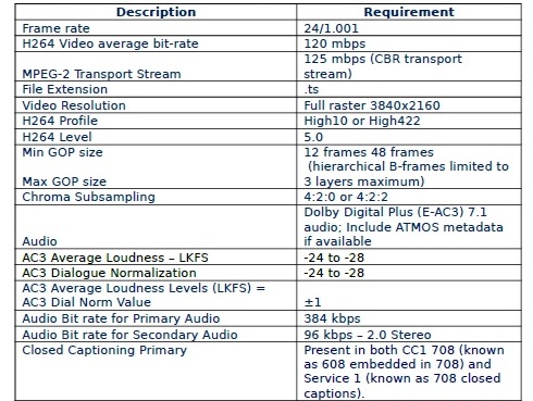

    Dec 2014
    Mumbai, India
    Hi Chris,
    Please let me know if below specs is possible using Avanti. I have tried video specs, they are as per my requirement but I not getting audio Dolby Digital Plus E-AC3 7.1. Also wanted embedded subtitle as per the specs.
    Vijay
    Sep 2007
    Europe
    When you ask if it's possible with Avanti, you actually ask if it's possible with FFmpeg. To begin with ac3 audio, FFmpeg reports...
    [ac3 @ 02f9f420] Specified channel layout '7.1' is not supported
    As for closed caption subtitles, FFmpeg can perhaps mux them in but not convert them from something else.
    I guess these are PRO requirements and I'm afraid FFmpeg isn't PRO enough for that. You probably need (expensive) payware to get what you want.
    Chris
