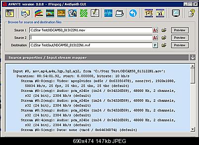

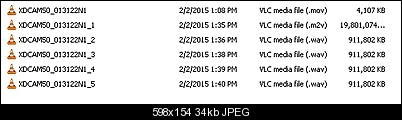

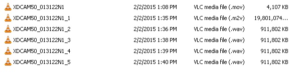

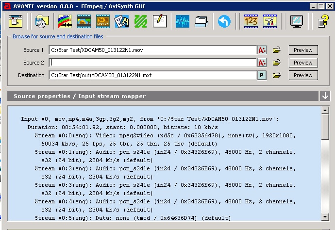

    Hi Chris,
    I have source which is in packaged format and have 5 streams as per below format created from Omneon server.
Name:	Packaged Source Files.jpg
    .mov file is link between all the streams, when I select the .mov source file in source I can see all the files available on that folder. I wanted to transcode them into XDCAM HD MXF format. But when I start transcoding, Avanti gives error "unable to parse option value -1 as pixel format". Is there something I need to add into FFMPEG script?
    Avanti able to import the file.
Name:	Avanti Able To Import File.jpg

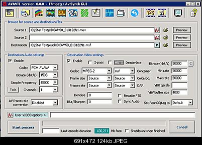

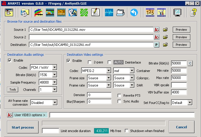

    My output settings are as per below.
Name:	Output Settings.jpg
    I am getting below error when I start transcoding.

    I'm already surprised that FFmpeg can read the mov. It's a small reference file, I guess.
    You can try to set a input pixel format at the "Colorspc." dropdown box. Probably yuv420p or yuv422p.
    Chris

    Try to load the m2v file at "Source 1" and the first PCM audio file at "Source 2" and still use the -vfin "format=pix_fmts=yuv420p" command because the m2v file doesn't specify a pixel format.
    [mov,mp4,m4a,3gp,3g2,mj2 @ 043cc060] Could not find codec parameters for stream 0
    (Video: mpeg2video (xd5c / 0x63356478), none(tv), 1920x1080, 50034 kb/s): unspecified pixel format
    Dec 2014
    Mumbai, India
    Chris I am able to transcode the file. Is it possible to use all the 4 track while transcoding?
    Sep 2007
    Europe
    Yes you can!
    1. Load the other three PCM files at the [USER_SOURCE_PATHS] section of the script editor.
    Use the "Insert Source" button at the script editor to do that (select "as... user source path").
    2. Double-click on the "Source 1" field to call up the source properties.
    All files will then show up there. Then use the "Input stream mapping" option (<Alt> double-click on the streams) to select all the streams in the order from top to bottom.
    You can first expand the source properties window (arrow button at the right of the header) to have a better view on all streams.
    EDIT:
    I wonder if it will work when you remux the video stream by setting video codec to "Copy Video"? That is, if the stream already fulfills your requirements.
