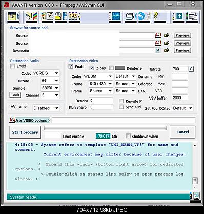

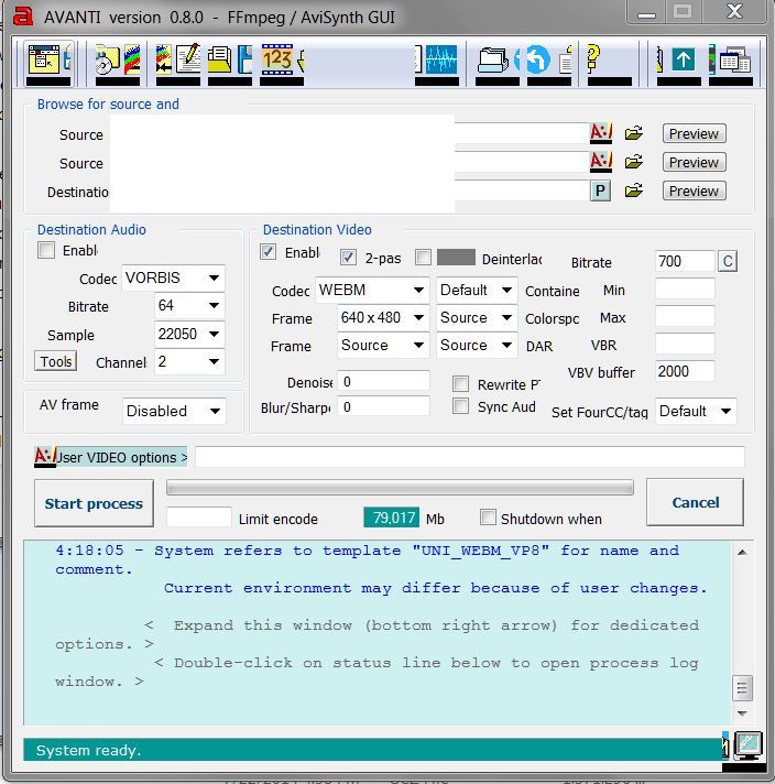

  4. Just a bug submission.
    OS: Windows 7 64bit
    Version: 8.0
    Problem:
    DPI issue. Icons are messed up, text is cut off.
    Resolution:
    Change DPI to "normal". Anything larger and I get what's below. I'm guessing this may be solved with a resizable window?

    Thanks for the submission!
    Unfortunately Avanti can only run on 96dpi. Aside from the main gui, there are a lot of other windows that then should be resizable too and it would still cause issues.
    After you change back to 96dpi, the gui should look normal again. I don't understand why it doesn't.
    EDIT: You can try to delete the "AVANTI.ini" file and launch it again. Perhaps it stored some odd window positions?

    Perhaps this explains why you couldn't find the button at its proper place (and why the gui looks clunky)?
    https://forum.videohelp.com/threads/282223-AVANTI-FFmpeg-Avisynth-GUI-%28support-thread...=1#post2336605
    Avanti isn't DPI aware as it is called by MS. Actually rather unusable at other than 96dpi.

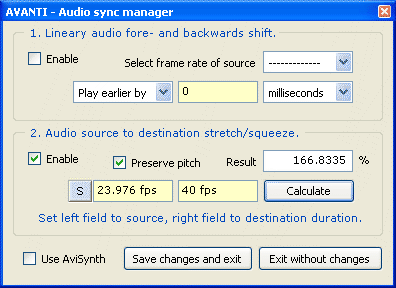

    For re-encoding, I could do it on the fly with FFmpeg only by using these settings at the audio tools and adding a redirected command at the script editor video settings.
    [USER_VIDEO_OPTIONS]
    -r 40 <<--
    # additional commands
    Redirecting with <<-- in Avanti means that the command is placed before the input file and forces to read it as 40 fps regardless of what it really is.
    Perhaps there are other tools that can do it on the fly but in this case vdub is indeed the solution.
