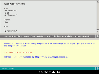

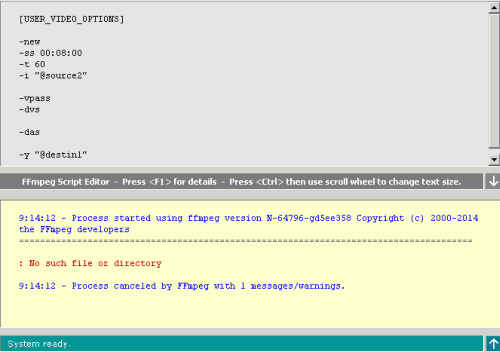

    "no such file or directory" error
    I've been using Avanti 0.8.0 intensively for over a week. I didn't pay any attention to the help file so I've used it in my 64-bit system in non-standard ways, e.g. with 64-bit ffmpeg or outside of the "program files (x86)" folder, with more or less frequent crashes but also many excellent h.264 encodings (better & faster than Handbrake). The color correction and crop/scale tools are great. Then for no reason the script editor, which used to show all the FFMPEG commands, stopped showing any except the ones I entered. The next day, FFMPEG started throwing the "no such file or directory" error. I tried switching to the recommended 32-bit ffmpeg, putting Avanti in the standard windows "program files (x86)" folder, and shortening the path, but no dice. As I see it, Avanti is just not passing the input path to ffmpeg, or any other commands except the ones I wrote, despite the fact that it passes them to FFPLAY for previews.
    Any suggestions?
