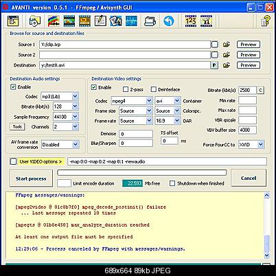

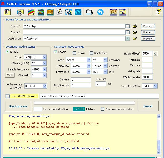

    But I have a problem in using AVANTI to output a video file with two audio streams.
    The following video options generate valid video output: -map 0:0 -map 0:2
    but the following video options: -map 0:0 -map 0:2 -map 0:1 -newaudio
    generate errors (see attached file for details).
    [Attachment 4816 - Click to enlarge]
    However the following command works as expected :
    ffmpeg -i \clip.trp -vcodec mpeg4 -vtag DIVX out.avi -acodec libmp3lame -map 0:0 -map 0:2 -map 0:1 -newaudio -ss 00:03:00 -t 00:01:00
    Am I missing something, or is it a bug?
    I am using Automated FFmpeg 32-bit Windows builds made by Ramiro Polla and FFmpeg revision: 26071.
    Thank you in advance.
  24. Member
    Sep 2007
    Europe
    You can call it a bug or at least that Avanti currently is prepared to only map out one arbitrary stream when a source contains more audio streams.
    But it can be done with the -new option on the command line. I would do it like this...
    To start with, don't add any mapping or -newvideo commands to the command line. Then right-click on the command line for the menu and choose "Compose '-new' command line (single source)". You then get this...
    -new -i "@source1" -dvs -das -y "@destin1"
    Then call up the source properties and double click in the left margin of the desired video and audio streams in the order you want to have them in the output file. This will add the map command to the end of the command line. You now should have this...
    -new -i "@source1" -dvs -das -y "@destin1" -map 0:0 -map 0:2 -map 0:1
    Now add the -newaudio command and move the -y "@destin1" command one position to the left (between the -dvs and -das labels). You then have created a command order like in your working example.
    -new -i "@source1" -dvs -y "@destin1" -das -map 0:0 -map 0:2 -map 0:1 -newaudio
    As you can see, Avanti puts by default the output command at the wrong position for this kind of mapping.
    Your problem comes at a good moment because I'm currently reworking the whole command line order. The FFmpeg docs distinguish infile from outfile commands and for both, the position where to put them is critical. I've already added a option to put infile commands between square brackets so you can tell Avanti where to put them. I'll also take a look at the mapping problem you've encountered.
    EDIT:
    Things appear to be a bit more complicated. FFmpeg expects a new set of audio settings for the -newaudio stream. If it is not given, FFmpeg uses its default audio settings for it which are low bitrate mp2 audio. I finally had success with this line where the -das label (destination audio settings) is used twice.
    -new -i "@source1" -dvs -das -y "@destin1" -map 0:0 -map 0:2 -das -newaudio -map 0:1
    This makes it tricky to automate it for the standard command line. Also hard to guess what the user wants because it's even possible to use another audio codec and settings for the -newaudio stream.
  25. Thank you very much . It works.
    I think I should spend more time in studying the program's help document.

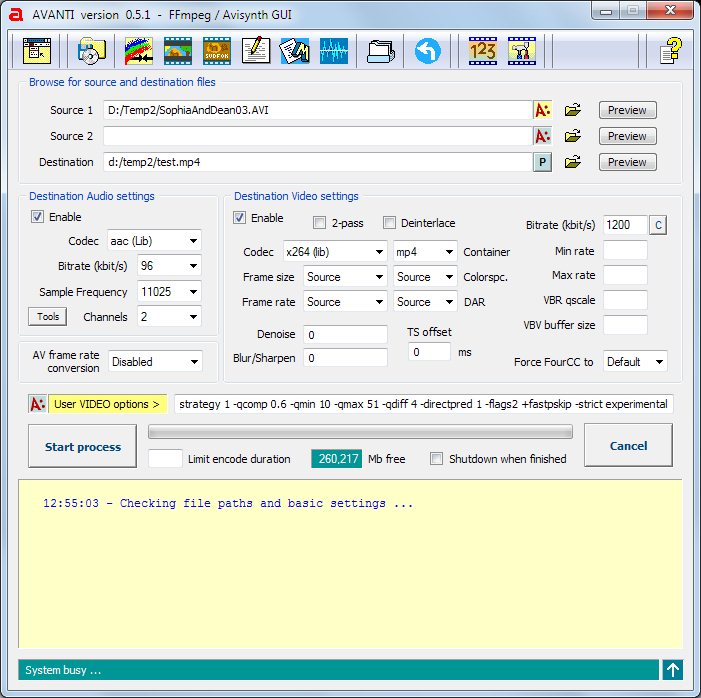

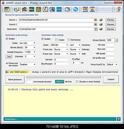

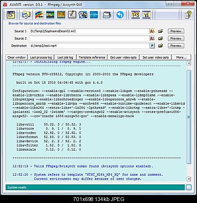

  29. Thanks for the quick reply Chris. I just tried the latest ffmpeg autobuild you mentioned. I get the same result: Avanti hangs on the Avisynth script. I also re-installed Avisynth 2.5, but no change.
    The first attached screen shot is of when Avanti starts up.
    The second screen shot shows the "hang up".
    PS: I'm a programmer. Is there any log I can look at to see what is happening?

  30. Member
    Sep 2007
    Europe
    Used same FFmpeg version and setting as on your screenshot and it still works. I still think it has something to do with your source clip. Please check out a few things.
    1. If you call up the source properties (at top left button menu), do you get them properly?
    2. If you press the "Preview script" button at the Avisynth editor, does it play the script?
    3. What happens if you change AVISource to DirectShowSource in the script?
    You may need to temporary add "ConvertToRGB()" at the end of the script for preview.
    There is a limited log of "get source properties" but I think it hangs there so it will not show anything other then the wait timeout.
