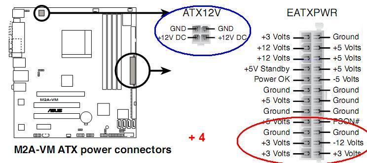

    The overall output power of a power supply doesn't always mean much. There are several different voltages available, +12VDC, -12VDC, +5VDC, -5VDC, then usually about +3 - 4 VDC for the CPU. And you can have more than one +12VDC rail. Each one has it's own power rating. On newer PSs, the +12VDC rails have been increased for power because of all the drives being used. And newer CPUs have higher power needs than CPUs from a few years ago. Video cards probably run off the +12VDC and the +5VDC and possibly the +3VDC rails.
    Here's a ATX PS pinout that shows the voltages:
