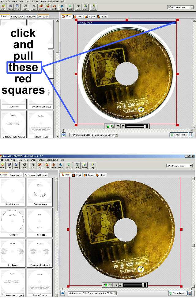

Oh boy I hope I'm not sounding too dumb but how do you bring up the red border with the squares in Acoustica?
Try this:

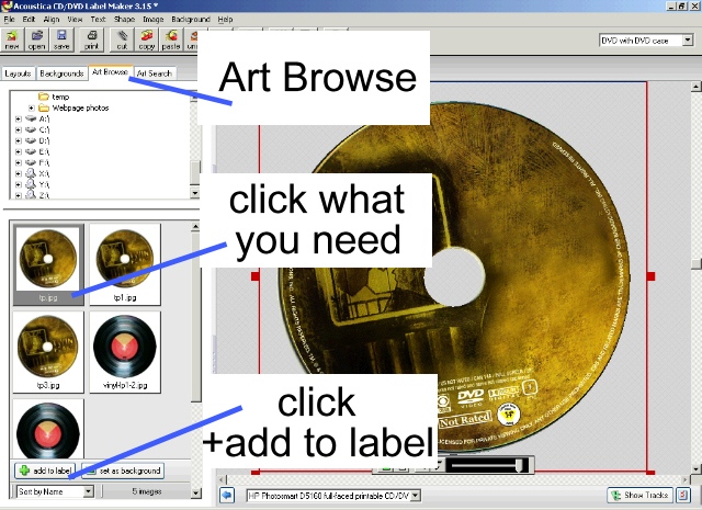

I noticed that if you click "set as background" you do not get the red squares. -
Wow it works I didn't know you just needed to click on the "Add to Label" button. So at least I know how to correct badly scanned labels which helps tremendously!

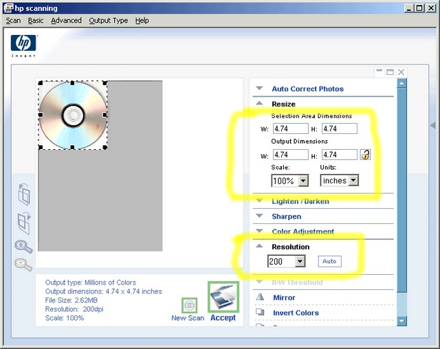

It would be nice though if the scans weren't like that to begin with, any idea what I'm doing wrong for my scans to come out like the Twin Peaks scans? -
Try this:
Launch HP Solution Center > click Scan Picture
adjust your Resize option to 4.74 by 4.74
