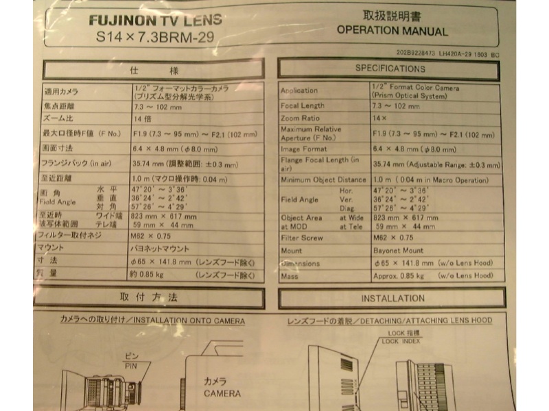

Google got me this.
Check the front of your lens and the lens shade to confirm 62mm filter screw dimension. I found this spec sheet on an e-bay listing but one other listing mentioned 58mm filters.
You can confirm spec with Fujinon or the filter supplier or ask online experts like these guys
http://www.fixya.com/support/p223197-fuji_fujinon_s14x7_3b12u_1_2_3_ccd/solutionsRecommends: Kiva.org - Loans that change lives.
