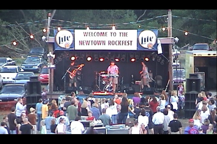

    It's called anamorphic, the video cam records like this (note the people look tall and skinny and this is 720x480 NTSC):

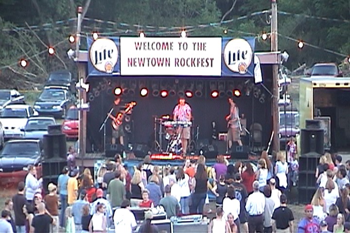

    You encode and author as 16:9, all this does is set a flag that it's 16:9. It doesn't change the resolution nor does it add anything to the video. The DVD player sees 16:9 flag and letterboxes the video adding black bars top and bottom which gives you this:
    How you do it with Pinnacle i have no idea, also be aware that some cams (and software) will record a pseudo 16:9 where the black bars are added by the cam or software like in the second picture. You don't want that.
