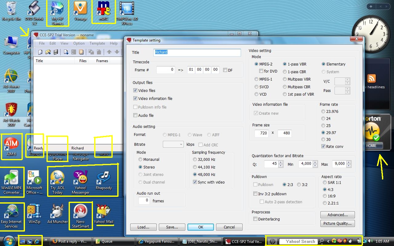

  1. I've been using CCE for a couple of years now, but I recently got a new laptop with windows vista. Since using CCE on this new hardware, I have been able to encode MP4s just fine, but the program completely crashes when it comes to encoding AVIs. Is this a common issue? Am I doing something wrong? Or is this totally new to everyone?
    To anyone who helps,
    Thanks in advance

    I started out using avisynth to encode just the AVI video and it crashed.
    I then tried to encode the AVI it through CCE directly, and it crashed.
    I encoded an MP4 through both avisynth and CCE directly, and it worked both ways flawlessly.
    I have been using BeSweet to encode the audio.
    The AVI files are anime episodes running just over 20 mins.
    I have used K-lite Codec Pack, CCCP, and i have tried installing xvid, haali, and ffdshow independent of codec packs, each gave the same negative results.
    I am using the Queue for Encoding process laid out at http://playbackhelp.com/doc/guides/queue/

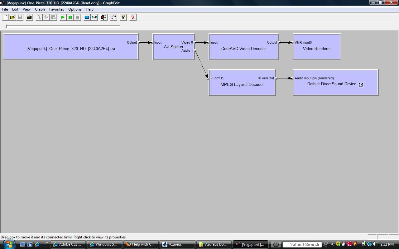

  18. I guess not much help on this issue thus far. I was thinking we can approach it from another angle. Maybe if someone can tell me why it can handle encoding MP4s, we can figure out why it crashes on AVIs.
  19. Try using AVISource with the AVIs, rather than DirectShowSource. Post any error messages here, if you can't figure them out yourself.

    First of all try to avoid long path names, it may give problems, use short paths and filenames
    try to open this scripts in WMP ( you may get a message that the file type is not recognized, ignore and just open )
    if you don't have image in WMP, post any error message it may give
    also, use GraphEdit to open that AVI files and post the image in here

    BTW...I don't know if CoreAVC video codec can decode XviD or DivX, what I know is that that codec is invoked to render AVIs
    I don't use CoreAVC to render H264, I just use CCCP ( FFDSHOW ) for that and some exotic formats, and :
    - DivX last version or....
    - Koepi XVid
    for AVIs, DivX last version can give you better speeds than koepi, for the experiences I made with users

    That type of error normally it is a memory issue or AVISYNTH version
    You must fix that, and your problem is either due to codecs or avisynth version
    - Try to install another version of AVISYNTH in safe mode, remove avisynth folder totally from your system, restart and try again to open that AVS scripts
    - avoid long filenames and paths
    - That AVI container files, what video codec does they have ? you didn't say that
    XVid ? DivX ? what I know is that your system decodes using CoreAVC...and CoreAVC as far as I know it is only for H264 decoding....never tried it
    XVid and DivX seems the same, but they are not. Xvid is DivX written backwards, but there is some characteristics incompatible

  28. Another possible cause for the crash is that your AVI container contains an h.264 stream which is known to cause multiple problems. You could confirm this by using mediainfo on your problem file.
    If this is the case, one option would be to demux the streams, and re-mux in its proper mp4 container and then proceed with CCE.
