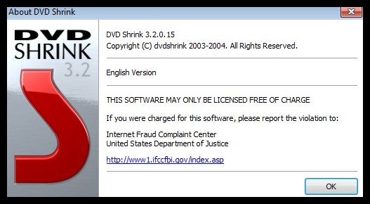

  5. So now it's New Year's 2013 & I just installed DVD Shrink v3.2.0.15 on Windows 7 Ultimate and I had the same problem - DVD Shrink would not start at all - no process ever started, period. I cycled through a lot of compatibility settings, etc. but no go. Then after reading this thread, I decided to add DVD Shrink to the Data Execution Protection exclusion list per Kongaloid's recommended fix, and the eula acknowledgement window appeared and when I accepted, Voila! DVD Shrink started right up. I haven't kicked tires yet, but at least I'm past a very frustrating first hurdle. Thanks to all of you for all your ideas and suggestions.
    PS - I had originally installed an evaluation version that asked for $$ to license it, but just by luck, I removed it and downloaded it from http://www.mrbass.org/dvdshrink/ (see budz's post) which when installed, would not run until I applied the DEP fix. I think the attached image indicates this installed version to be an official version:
Name:	About DVD Shrink.jpg
