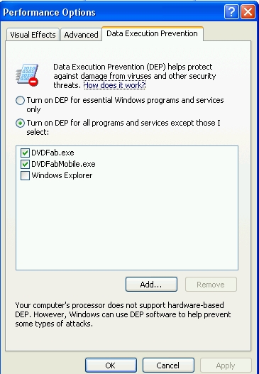

    No one has mentioned the Data Execution Prevention issue that DVDShrink has with Windows XP and Server 2003, (Vista, etc.).
    If DVDShrink is not included in the exceptions it simply will not start.
    If you are still having this problem try this:
    1) Start / Control Panel / System / Advanced
    2) In the Performance section click on Settings
    3) Select the Data Execution Prevention tab
    4) Click Add and browse to the DVD Shrink 3.2-exe file (Click Open)
    5) Click OK, and again.
    Just another solution for the same issue, I hope it helps.

  26. Question: (To the user who found FFDShow was the problem) just as an experiment, if you delete FFDshow, can you then use DVDShrink?
    Also, I never added DVDFab to my Data Execution Prevention (see above post) , but I was surprised to see it installed there. (See screenshot, I have DVDFab installed on my computer)
  27. I'll be darned, I had a look and DVDFab was there in my DEP list. And the checkbox was ticked.

  29. DVDFab automatically adds itself to DEP exemption, the maker said it's so PathPlayer works properly.

    And thanks for the explanation about DVDFab and DEP, Moviegeek.
