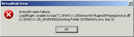

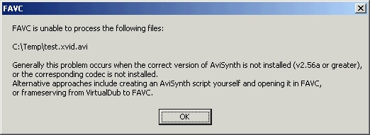

    Can someone who has had problems with 1.05 try to open one of the generated avisynth files (from a working folder) in virtualdub and help me to find what the problem is?
    Aug 2007
    When first clicking "Generate DVD" I am presented with this message
    When loading the v1.05 generated .avs file in VirtualDUB, I am presented with this message
    The Title0Info.avs file contains the following text:

  12. Member Mr_Odwin's Avatar
    Feb 2006
    Thanks powerpc123. That helps me.
