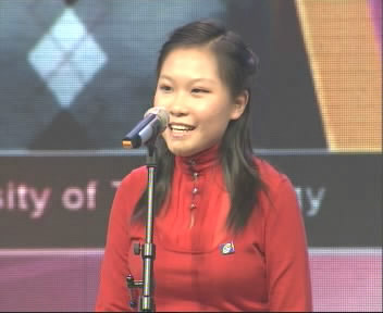

 btw - the pic you posted does look nice, very pretty lady too.
