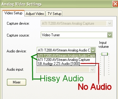

    When this card was first installed, it appeared that none of the other programs that I could cap with would work with this card. The only thing that I had that would cap with it is the MMC 9.12 that came with it. It apparently has something to do with the ATI T200 Unified AVStream Driver ATI started using.
    During the much time that has passed, I've tested a few programs that have come my way and discovered one other program that could cap from TV with the ATI AIW 2006 PCI-E (Cyberlink PowerDirector and the audio still has hiss with that too. )
    But it was only successful at capturing the audio along with the video (which is nice to have ) if I told it to use ATI's "ATI T200 AVStream Analog Capture Audio device".
    AHa! So it's not using my sound card

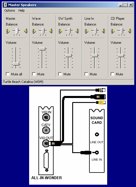

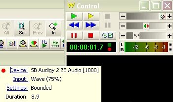

  5. For the audio fine tuning i suggest two things:
    1- use a software like goldwave to have a precise view of the audio level
    http://img242.imageshack.us/img242/5111/image1hc8.jpg
    2- adjust the sound with the audio control panel
    http://img245.imageshack.us/img245/3806/image2ha7.jpg
    Once the fine tuning is determined for each channel try to find an intermediate level so that way it's good for every chan.
    That's how i do and so far so good

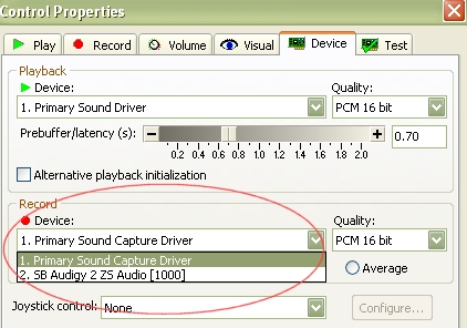

  6. Thank you for your reply
    I downloaded and installed the trial version of Gold Wave but can't seem to find the info about the audio level.
    I did explore around the program and stumbled upon an area where my sound card was listed but nothing for the ATI "T200 AVStream Analog Capture Audio device".
  7. Originally Posted by somebodeez
    it should be in TOOLS>device control
    a window will pop up with left & right channels bars
    you can choose your device (sound card or tv card or else) in:
    OPTIONS>CONTROLS>DEVICE
    To get them working ("the bars moving") you must proceed as if your're about to record something with goldwave so click on:
    NEW>CD>stereo>44khz>lenght: 1.000 (the shortest possible that way you don't spend 5 min waiting for nothing)
    There you go

    First off. I've always heard that ATI cards have problems with Sound Blaster cards.
    With ATI cards, you have to connect the audio out from the capture card to the Line In on the sound card and you need to make sure that the volume is turned up in the Volume Control and that Line In is set for recording in your sound card properties.

  12. I tried Goldwave again but I'm still not seeing ATI "T200 AVStream Analog Capture Audio device" listed in the Device area.
    Just my sound card and "Primary Sound Driver" which evidently also means my sound card since that's what it appears to use no matter which one is selected.
    And I can't figure out how to translate what the color bar is telling me.
  13. Tested capping using PowerDirector (the only other program I've found so far that can cap with this card)
    and I cannot get audio captured when trying to use my sound card. I have to use the ATI thing.
  14. Originally Posted by somebodeez
    Very strange, i got an old version of goldwave so it don't look exactly like on your snapshot but i have my audio card (realtek HD) and tv card (audio-cynergy 250) listed so i don't know what to say.
    Here is a snapshot
    http://img142.imageshack.us/img142/7/4984ki6.gif
