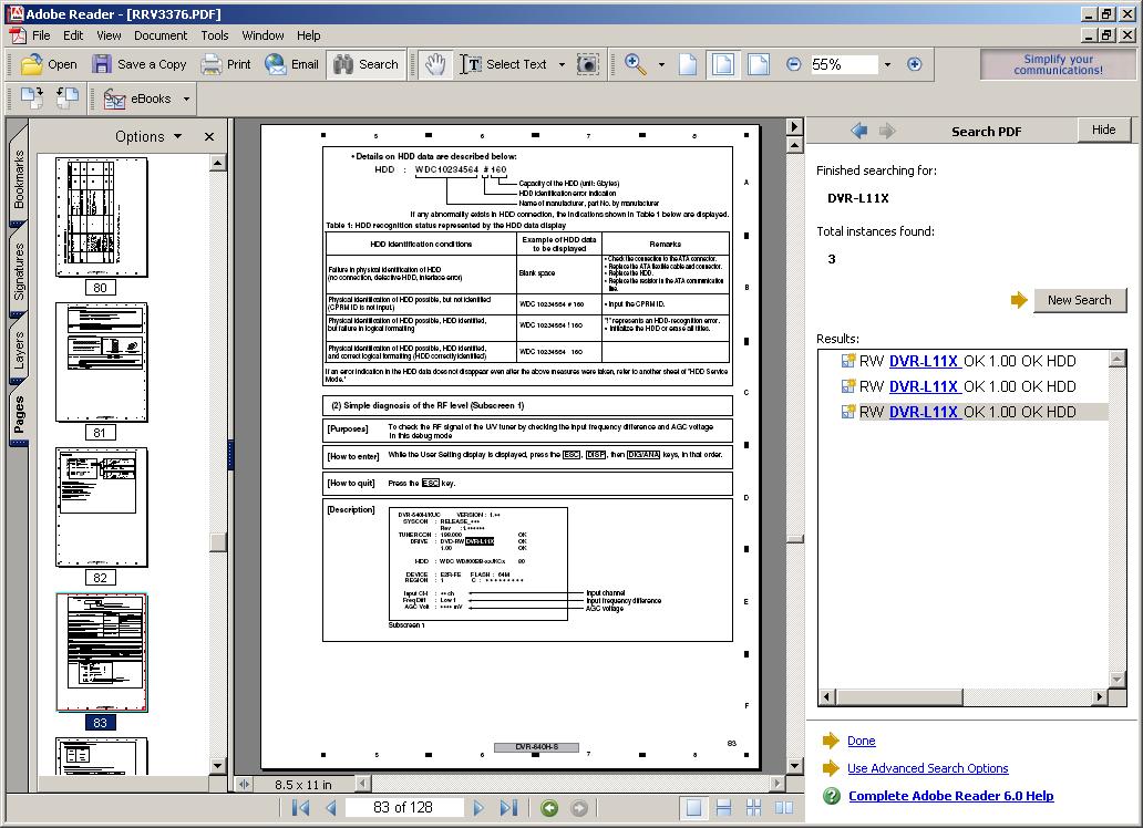

this came up for discussion in at least one earlier thread here. Right now, I don't recall if you were one of the participants, but it seems quite possible. I mentioned what I had found in the Service Manual for the 640. If the system will allow it, I will attach the relevant snapshot I extracted from this, below. The unit "RW-L11X" sounds suspiciously similar to the 111 Pioneer burner designation. (Fairly early during the period the 640 was being sold, someone told me the burner was functionally similar to the 111 . . . but at this point I don't recall who.) If there is anything to this, it may be that some production models of the 640 had such a burner, or, at the very least, Pioneer had planned to use it at the time the service manual was written. But you seem confident that things turned out otherwise.
As you said, we may not know for sure until someone fully disassembles one of these -- and maybe someone who knows just what to look for. In the meantime, I take some encouragement from what you indicated about the apparent hardiness of the 640 burner. (Perhaps it falls in the anomalous range, but my 520 has seen regular, extensive use since I got it -- which must be a couple years now -- and the burner in that one is still getting the job done.)
