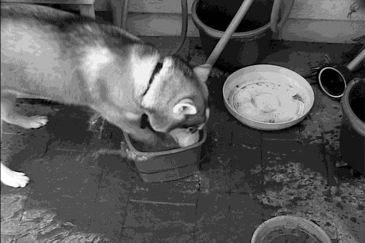

Here's an example. An HuffYUV encoded grayscale AVI file with all luma values below IRE 0 (Y ranges from 0 to 15):
huffyuv.avi
No amount of filtering in VirtualDub will bring out any details in this video. Here's what AviSynth can do with ColorYUV(gain_y=4096):
