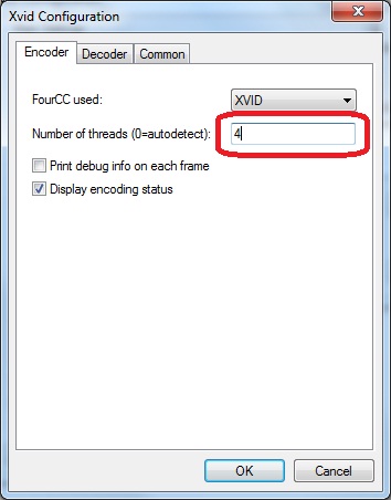

    Have you seen this box in the XviD codec settings?:

    Hi,
    Not that exact window, But I found the one inbuilt into avidemux under "Configure" for the xvid codec.
    Under "Configure" on Avidemux to set the bitrate etc there is a option for the multithreading, default 4, when set to 8 it makes no difference.
    Only 4 threads are still being used on task manager, and 30% Load.
    Thanks.

    Looks like xvid only supports 4 threads max, since my i7 has 8, when changing the setting from 4 to 8, I notice no performance increase.

    If I set the thread count to 8 and close the dialog, then reopen the dialog, it says 4 again. I have a quad core (non hyperthreading) CPU so I don't know if Xvid is limiting the thread count to the number of cores or if 4 is its max.
