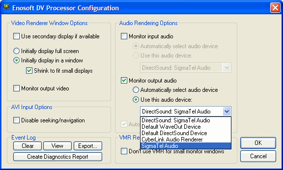

Hi Jensen,
Vista processes audio in a different way than XP and it can lead to playback problems. Often this shows up as slow playback and erratic audio.
Our software has a way around this that may help you together will some other suggestions:
1. Use this version of the software: http://www.enosoft.net/dl.php?filename=EnoDVProcessorSetupUnlicensed103PreviewA.msi (it fixes a few bugs)
2. Install the software onto your main drive and capture to the external drive
3. Capture to Type-1 DV AVI (Type-2 creates a second, separate copy of the audio that can lead to problems.)
4. Configure our software to use a different set of audio drivers. Open the main Config... options and select the output audio as below. Choose an option that isn't "Default" anything or "DirectSound" anything. When you have captured a video, open it in our software and play it to a video window renderer (in the output list of options). If it plays OK then the file is OK. However, it may still play incorrectly in other software that isn't Vista-savvy.
John Miller -
