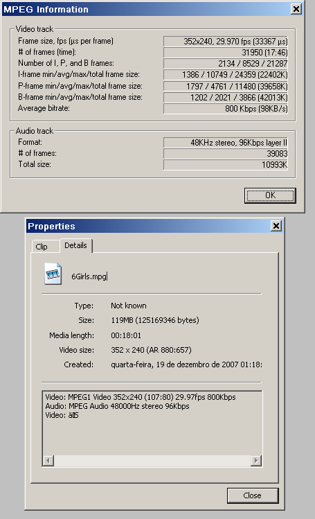

    If your problematic mpeg-1 can be played back in MPC or WMP,
    then (I guess) it's not improbable that you manage to "push" it
    into your favorite encoder via Avisynth. Speaking of badly-created
    MPEG-1 videos, here is the latest one I have met

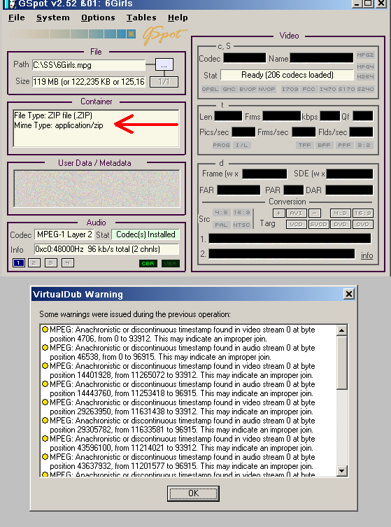

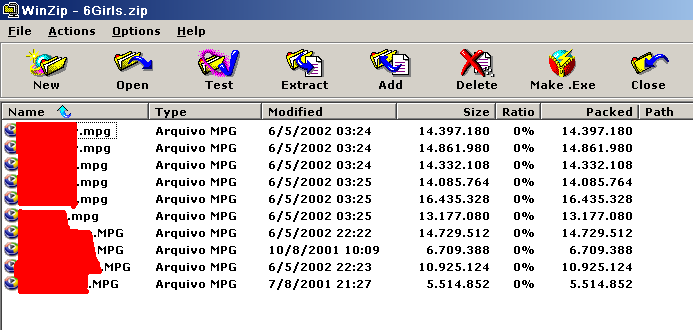

    Overdue update ( or, "much to learn I still have" stuff... )
    Well, I decided to trust my old version of GSpot and renamed the file
    6girls.mpg to 6files.zip in order to know what WinZip had to say about it.
    BIG surprise
    I did not know that VirtualDub and MPC could be SO versatile
