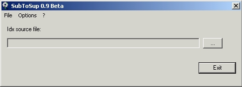

    Required Tools: Subtosup and DvdsubEdit
    1. Launch Subtosup. Click [....] or File then Open.
    Browse to the folder that contains the IDX file, then double click file to Open.

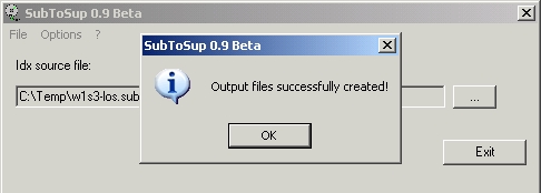

    2. A Subtosup 0.9 Beta window will appear, just click ok and close Subtosup.
    A subtitle-id_with different langages will appear in the folder.. (example: subtitle-id_en_0x20).

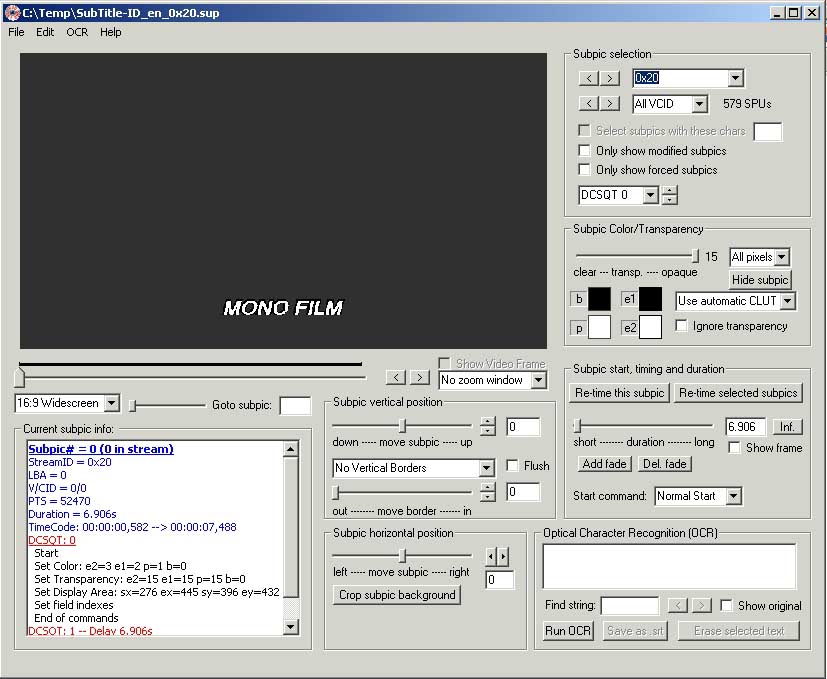

    3. Then launch DvdSubEdit. Drag n drop subtitle-id_en_0x20.sup file onto DvdsubEdit window.
    2nd window will appear requesting ifo, just press cancel to continue.
    4.Now Look to the bottom right of DvdSubEdit window, there's a button call "Run OCR".
    This process the sup file.
    A "Running OCR" window appear.

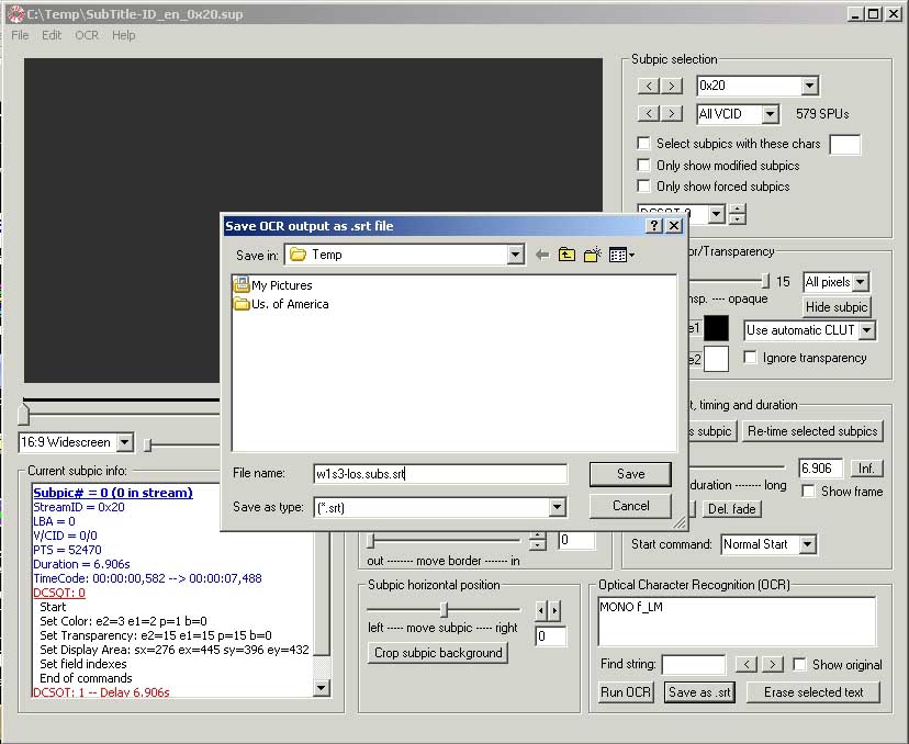

    Once finished, your now able to press "Save as .srt", a "Save OCR output as .srt file".
    Note save the srt with the same name as your movie file but with the extension .srt
    (example: if batman_forever.avi is the name of the movie then batman_forever.srt is the subtitle file you save.)
