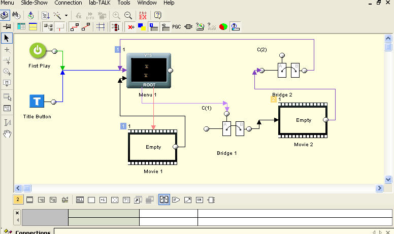

It's easy.....
Just add a new VTS in DLP, add two bridges, they can be added from the bottom of the connections window, use them to bridge to the new vts and back from it.
If you want to add a second menu for the second VTS video, say a chapter menu as it's easier than adding 20 bridges from the main menu, just add it in the new VTS and bridge from that back to the main menu.
If you have a bunch of diff. vid you can make as many VTS's as you need, but everything in the same VTS must be the same specs.
