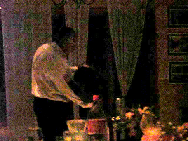

P.P.S. here is frame 471 (almost pure black in the original)

Broka, here is a rough idea of what you might expect. Naturally you might want to fine tune the clean-up etc...
http://rapidshare.com/files/77802348/NEW-Copy_of_MOV00571.rar.html
