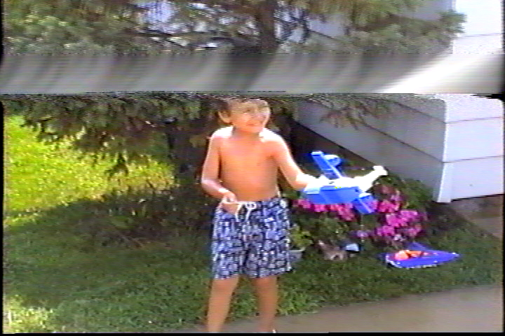

I am capturing a 7 yr. old VHS-C tape via a JVC HR-S9800U to a Datavideo TBC-1000 to a ADVC110 capture card. The TBC on the VCR is off. I am getting this distortion on the clip I hope I uploaded correctly. Should I mess with the video calibration on the VCR? Any other ideas? I'm still a noob, so I might need a translation with techno-terms.

Have you tried another vcr?,looks like the tracking could be way off.

That distortion is a tracking problem,if you cant track it out then it was recorded that way and no filter or tbc will clean it up.

Thank you both for replying. I have tried manual tracking, but it is still there. It will 'roll' at the worst part of tracking, until I readjust it.
I am connected via S-Video. So, we have a mystery. Is this also called 'flagging' or 'tearing'? It seems like something could clear it up--it's not on any of the other tapes I have of the same era and recorded with the same camera. And the first part of the tape doesn't have it. Go figure.

What you might check: Take the VHS cassette out of the VCR. Push the small button on the left side and open the cover. Take a look at the tape, particularly the edges. If it is cupped and the edges show uneven wear, then the tape may be damaged and there is not much a VCR can do.
More likely it was recorded on a out-of-spec VCR and unless you can find another unit with the same flaw, you may have a hard time playing it back properly. Not much advice there except to try different VCR's.
If it's a valuable tape, you might look to a professional company to recover it. As long as you can see the results before you pay.
I disagree on the tracking issue, at least at first. In my experience, that sort of on-screen glitch appears to be physical damage to the tape itself. Tell me, is the magnetic tape clean and free of crinkles, rips, creases, or other debris?

I have looked at the tape and I see just a tiny bit of cupping on the edges. I recorded it on a Panasonic VHS-C player that is now out of commission, so I can't replay it on that camera. I played it on my old Quasar VCR and the distortion showed up as a horizontal line of static a third of the way down from the top. I have captured several tapes of this era and older than this, recorded on the same camera, without this problem

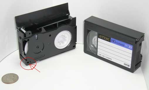

Edit: BTW did you get the manual rewind figured out? If not, turn the tape over, with the flap facing away from you. At the bottom left corner is a hole about an eighth inch diameter. Push a pen or toothpick in the hole. This will release the spindles and you can rewind it manually."Shut up Wesley!" -- Captain Jean-Luc Picard

With VHS tapes, there is a small 'window' on the bottom middle of the tape with a spring loaded flap. You push that in and it should release the tape to turn. I have used a pencil on a cassette tape in the drive hole, but your tape may take something larger to turn the spool. Keep a bit of tension on the opposite spool with your finger to keep the tape taunt.Originally Posted by Theresa
I thought we were talking about VHS-C?Originally Posted by redwudz"Shut up Wesley!" -- Captain Jean-Luc Picard
Buy My Books -
We are, but I assume they are similar to VHS in construction.Originally Posted by gadgetguy
This is the hole I was referring to. (Thanks for the pic, redwudz)"Shut up Wesley!" -- Captain Jean-Luc Picard
