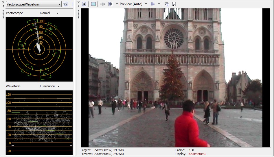

I transfert my dv tape with Windv to encode it to DVD but I'd like to improve some things.
First on this picture on the right, I say a blue vertical "halo" between the wall and the sky:

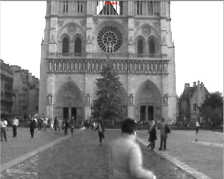

And also the red seems to saturated:

You're seeing the limits of 8 bit video. You just don't have enough levels of gray to handle the center screen and that sky. The red can be toned down with filters. The sky can be replaced with a simple luminance key.
If you were shooting with a Sony VX2100 the "knee" would have avoided that clipped sky. As it is it must be fixed in post.
You can see here that the sky is hard clipped to 255. That makes it easy to replace.

I use traditional video tools. I'll let others comment on best avisynth filters. If you use an HSV filter, just adjust S down.
The goal is to draw down saturation on the red.

Colormill will help you get a better balance back. I don't know of any keying filters for virtualdub, but the likes of Vegas or Premiere have the ability.
