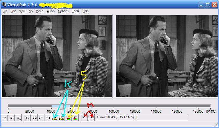

    This is a bit basic, but should get you started:
    The 'M' is the markin/markout where you select your cut. You can use 'Edit>Cut' to remove that clip, then go to the end of your video and paste it. After you have done all your cuts and pastes, select what's left of the unwanted video by markin/markout and delete it. All your clips will be left over. That's one method. Another is to use markin/markout and delete or cut everything you don't want and the leftover will be your clips. Sounds a bit backwards, but it works.
    The 'K' is to jump to keyframes. If you are using DV, they are all keyframes and editing can be done anywhere. Compressed formats like Xvid only have keyframes every 300 frames by default, so accurate editing is difficult. The newest VD has 'smart rendering' and that will allow you to cut anywhere. Without smart rendering, Xvids can only be cut at keyframes unless you want to re-encode it all.
    The 'S' is for scene detection. Handy for finding breaks like commercials.
    Most all the icons will tell you what they do if you hover your mouse over them.
    It's fairly easy to use once you play with it a bit. You can save it out as a 'Direct stream' copy at any time, then add all your clips back in and arrange them as wanted. None of this will damage the original video as long as you use a different filename when you save.
    Some guides for VD: https://www.videohelp.com/oldguides/virtualdubedit and there are lots more at the bottom of the VD toolpage: https://www.videohelp.com/tools/Virtualdub
    I should mention if your video is DV, you can also use Windows Movie Maker to edit and output as DV-AVI, then encode that with a different program. WMM is a fairly easy to use editor, but doesn't accept most AVI except for DV.
    Hope that helps a bit. The guides do a better job than I did at explaining it all.
