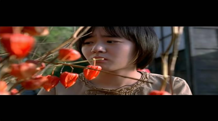

  9. Where did you get those resize and addborders lines? Those are not the proper figures for a 496x272 source AVI.
    For 16:9 encoding try:
    LanczosResize(720,480)#no addborders needed
    and for 4:3 encoding:
    LanczosResize(720,352)
    AddBorders(0,64,0,64)
    What you have in your script together with 16:9 encoding is a recipe for very bad AR. Also, check your script by trying to open it in VDub(Mod) to make sure there's nothing actually wrong with the script. That 10 second duration reported by CCE makes me suspicious.
    Feb 2007
    It really does have a very bad aspect ratio, but for some reason, I really like borders so I made them myself. I know, it's really weird. I don't know, I will probably change it later.
    Okay, well I made a script that included audio or vdub won't let me open it and everything seems fine. I don't know why CCE does that, but it encodes way more than 10 seconds of video because I actually finished converting my files a few times and have played the .mpv files. Except, each time I've been going over the size limit, so this time I'm encoding my audio files separately. I don't think that will help, but I'll try it. I'd get better quality audio anyways.
    Anyways, thanks everyone for your suggestions.

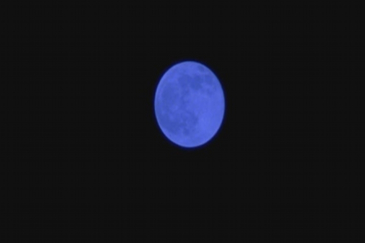

  11. You don't seem to understand. Your pic is of the unresized 720x480 video. After encoding for 16:9, it becomes even wider after being resized (to roughly 854x480) for playback. That is, it'll become even worse looking. And adding black bars where there shouldn't be any is a ridiculously stupid idea. Here's how it will look after being made into a DVD and resized:

  13. It's a switch, isn't it? Usually people come around asking how to get rid of black bars, and here's friedtofublocks wanting to add some in.
    Admittedly the pics don't show just how bad the DVD he's making is really going to look. The point could be better made with a nice big picture of a moon or something round.
    Feb 2007
    Ew, I guess that is really bad. I'll go easy on the borders.

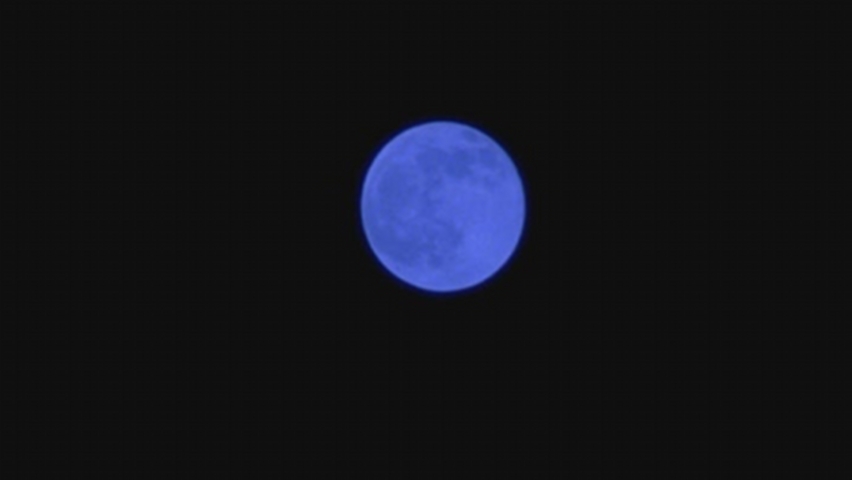

  16. Member FulciLives's Avatar
    May 2003
    Pittsburgh, PA in the USA
    As already stated ... in order to make a 16x9 WS NTSC DVD all you have to do is resize the original 496x272 image to 720x480 and encode as 16x9 WS NTSC.
    If you are using AviSynth then you would simply do the following:
    LanczosResize(720,480,0,0,496,272) or simply use LanczosResize(720,480)
    If you want to account for TV OVERSCAN then you could instead use the following:
    LanczosResize(672,448,0,0,496,272)
    AddBorders(24,16,24,16)
    Either way you are making it 16x9 WS NTSC using these figures.
    You might want to try "FitCD" for this ... it's a great freeware program for correctly resizing AVI files for DVD conversion and it will make a simple AviSynth script for you.
    Here is a visual example:
    Original at 496x272
    Resized from 496x272 to 720x480
    You will notice that the aspect ratio seems "wrong" when you resize from 496x272 to 720x480 but that is because 496x272 is in square pixel resolution (proper for a computer monitor) whereas 720x480 is in a 16x9 WS NTSC ratio so it looks wrong on a computer screen but will look proper on a TV. In fact it will look like this on a TV:
    I hope that helps
