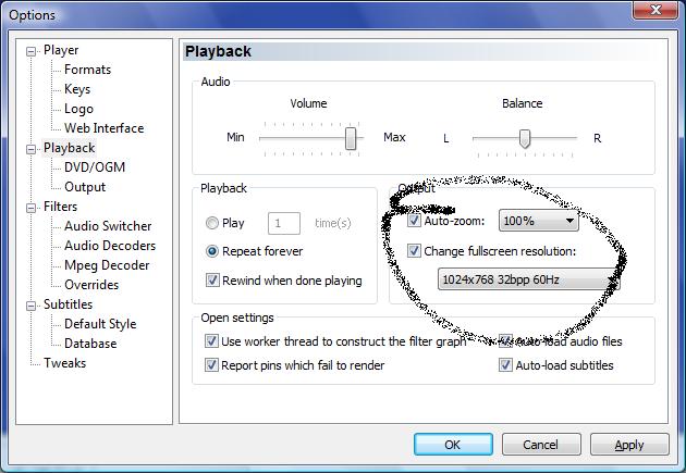

Is this what the reference is for on media player classic for example?
Would that be enough to enable upscaling? I don't have my pc with my hdtv right now. I'm not sure when I'd move it back again for testing.

I don't know what that pic's from, and I don't use an HTPC, so I can't help. I only posted the link. There's a lot of other information, stickies and threads, that you might find useful in that AVS HTPC forum.
