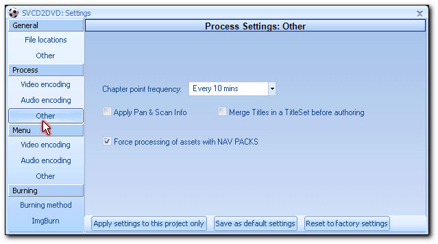

    Tis done. 3600 now has the option in question:
    VOB2MPG PRO, Extract mpegs from your DVDs - with you in control!
    Oct 2005
    I downloaded today's version and changed the setting mentioned above, but I'm still getting a null pointer.
