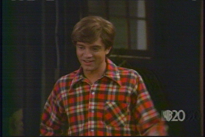

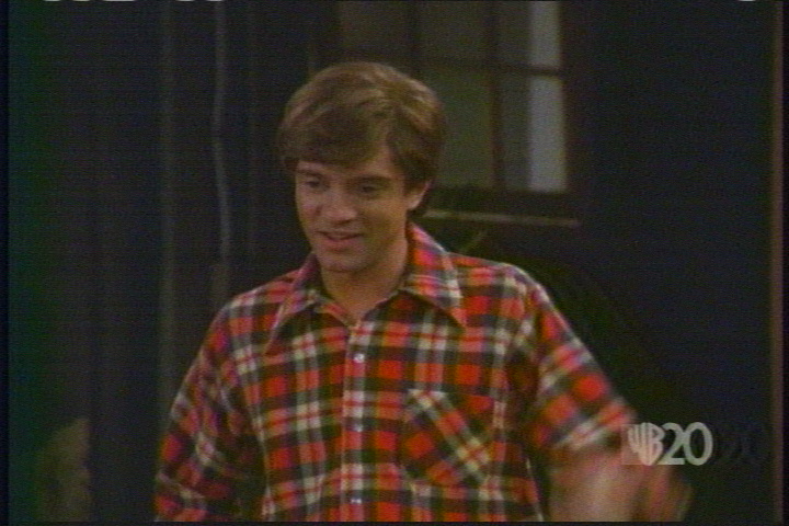

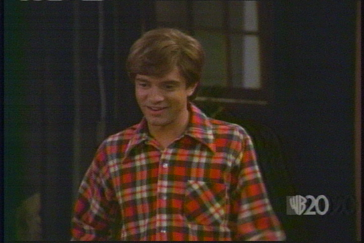

    Although I haven't actually done any 'logo removing' programming projects of my own, I've
    always wanted to take a stab at it and add it to the list of things to do one day. I mean,
    it would seem its pretty easy to do, I think.
    But, working with logo removal is very close to image filtering -- the pixel manipulations are
    based on simple math principles, though I don't actually know what math the delogo algos
    require.
    But I'm guessing that you need to start with two images.. one original (A) and the other
    one (B) made the inverse of (A), and then you apply either a Subtraction or Difference to
    the two and somehow the logo is somewhat removed. Of course, the algo would intail
    the params for the image coordinates location of the logo. Still, I don't know. I'm just
    theorizing on this over here at the moment. I don't know.. maybe I'll add it to my filter
    template and give it a go on a slow day or something. Anyway.
    lordsmurf I know how you feel about logos.. they are the evils of devils I tell ya.
    They were put there to annoy us (or those who copy vidoes or whatever) its more like,
    payback or something. Specially those large (animated) logos that alert you of a show
    coming up next or slated for a certain date. I mean, they just aired a short preview of
    it in the prev commercial. Then, half a minute later, they animate it (again -- to annoy
    us) and blurt the preview to come. There's no good in all that nonsence!
    Regarding the logos.. I think that part of the reason why you see left over gibblets is
    because of the noise around pixels within the logos' general area, as this is hard to lock
    onto with an algorithm designed to 'reverse' the opque'ness of the logo onto of the video
    image.
    The (logo'ed) pixels all have to be the same color within the r/g/b color components, and
    the image itself has to be as well. If the video source is from an Analog type source, then
    you already know how almost impossible it will be to remove, because of the SnP noise
    surrounding the whole image, randomly. Then there is the other aspect of this nonsence,
    the YUV color space vs. RGB, for when the video is decoded during capturing and/or video
    processing. These attributes *add* to the nonsense, compounding it worse.
    I would think that if the source was something from a digital medium, like an mpeg from a
    satellite or digital cable, you would have a clean non-distorted image, and most de-logo
    algorithm tools should be able to remove them. I would assume such. But I could be wrong.
    Case some don't know..
    From my understanding of video imaging and logo removing, the process should be applied
    to the original source -- not resized or filtered, and deff not ivtc'ed either. You have to
    start with the original source, as captured, and without hardware or other external filtering..
    and that includes, color adjusting as well. For best results, always use the raw source as
    the primary for logo removals. And, during the attempt of removal, it should be done inside
    the sources original frame rate. That means, if its an interlace or telecine video, it should
    be applied during this setup, raw. If you applied an ivtc to a given video and then apply a
    logo removal, you loose the videos' frequency consistancy/pattern because the frames
    were removed and the pixels no longer match those frequences. This will most likely result
    in gibblets and things. Anyway.
    Digital (mpeg) vs. Analog video sources are two different beasts. One has a lot of random
    noise, otherwise known as Salt n Pepper (SnP) and is beastly to work with in some cases.
    Here are a few videos (from the hit tv sereis, That 70's Show) when it was aired by WB.
    The source was from my JVC vcr unit, and source was from Analog areal Antenna TV, and
    captured by my ADVC-100 dv box. The video is where Eric was waring a red-checker shirt
    and he was rainsing his left arm up and then down. I then ran the dv video through vdub
    and Ctrl+1 to clipboard and then pasted into ms paint, where I exactly measured it
    for a (560x380, 96x52) screen coordinate copy and then pasted into another ms paint and
    finally, saved as a bmp file .. for consistancy -- source, as captured back in 11/21/2005.
    PARTIAL IMAGES:
    ** image snipped using pixel coordinates: (560x380, by 96x52) of original images (below)
    FULL IMAGES:
    ** (note, all images are in PNG lossless format)
    If you'll notice, in this video sample clip of the logos, there was some 'ghoasting' from the
    areal signal. Just another piece of the nonsense of trying to remove the logos.
    Oh, and by the way.., the image demonstartes my long-time plauge of Line Noise from that
    old ERA.
    -vhelp 4466

  25. Member gadgetguy's Avatar
    Feb 2002
    West Mitten, USA
    I have experimented with logo removal a great deal and for the most part, I agree with lordsmurf about what's left behind being more distracting than the original logo. Having said that, IMO the delogo filter does a really good job of removing an alpha blended logo. But only if you have a good source to start from. I seldom have a source that's good enough to remove the logo without using "repair". Using "repair" does leave blended "blobs" and to my eyes makes it more distracting than the original logo.
    However there have been rare occasions where the signal was good, and the logo was transparent enough to not require "repair". On many frames, maybe even most frames, it completely removes all evidence of the logo. Unfortunately, even in the best conditions, it does not completely remove the logo on all frames and whenever the video switches from "clean" frames to "dirty" frames, there appears to be motion where the full logo used to be. In certain scenes it makes no difference because there is enough action occurring in the rest of the scene to render it un-noticeable, but at times it's distracting. I wouldn't describe whats there as a "moving blob", but there is enough distraction there to draw the eye away from the intended center of attention.
    http://ericbt.home.comcast.net/SourceSample.m2v
    http://ericbt.home.comcast.net/DestSample.m2v
    The capture setup for the source for these clips was cable-> vcr tuner -> camcorder passthru -> WinDV -> DVAVI Type1. The first clip was encoded without any filtering. The second I used the DeLogo filter in an AviSynth script then cropped the borders and resized for 16:9 encoding. I chose this particular clip because this area demonstrates where the results are the worst of this entire episode. The remnants of the logo are clearly visible on several of the frames included in this clip. I would not characterize this residue as a "moving blob", but it is there. Whether or not it's noticeable or distracting is in the eye of the beholder.

    Now, I took the time to review quicly the two pics posted above. On my main pc, and
    inside RGB color space, I could not really see any descirnable differences. I'd 'ov had to
    really be looking for something. And, because I would know where to look, it would be
    that much more easier. So, I wanted to give a better un-bias review, and so, here is how
    I went about honestly reviewing it
    A few notes about my setup:
    I have a KVM switch to control two pc's, hooked up to one keyboard and pc monitor
    My main pc has the ATI graphics card
    My XP Home computer has a built-in NVidia graphics card which i use as the default
    After conveting the two .jpg images to .BMP files, and I rename them to 01.bmp, and 02.bmp,
    and then I made two sets, one for my Main PC, and the other for my XP Home computer.
    Then, I did the following:
    I imported them inside VirtualDub.. on both computers. This made it so that the bitmap files
    could be seen as an avi file. So both computers had the same sets of .bmp files.
    Then I created a sign-post (psuedo avi file) and frameserved it into TMPGenc.
    Then, on both computers, ready and frameserved into TMPGenc, I proceed to turn on it's
    Overlay feature, which operates inside YUV color space (though, internally for image, we
    all know that it on-the-fly converts it to RGB so that we can see it, because we can't
    see the YUV color space image as it is, in that container format)
    And, my results came out like this:
    XP Home comptuer, the TMPGenc test proved nothing. I could not decirn anything odd or
    bad about the de-logo'ed images. They were in effect, flawless, imho. Even in the YUV
    color space, the image removal of the logo was as clean and flawless as one could ever hope
    for.
    My Main PC, however, releaved the opposite. I could see the blotches or ring or something
    that resemble what was left behind from the removal of the logo. It was definately there.
    Although this demonstration was crude, (two pics) it was very limited and unsatisfactory.
    But it did prove a few points.. that most graphics cards of today (and tomorrow) will hide
    or elude the true attributes of a given video/image. And weather or not inside YUV color
    space or RGB, there is no descirnable'ness to be noticed while reviewing a given video.
