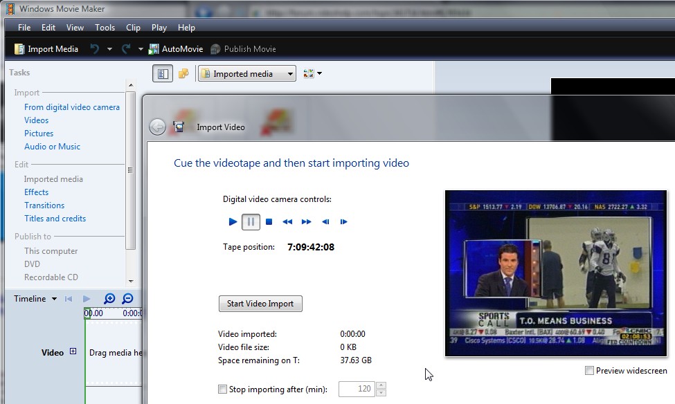

    When you select import from digital camera, you should see your camera as a selection. Here is what it looks like in Vista.

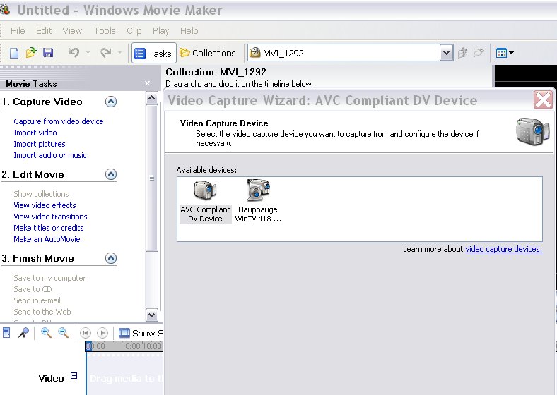

    Movie Maker in XP looks like this. If Windows detects your camcorder, it will appear here as a selection.

    Yes, that looks like the screen I see, but when I bring up the page and then turn on the camera, I get zippo--just a Not Detected msg.
    I still have a feeling some option in the camera isn't set properly. If I can get another firewire camera, then I can see how it works.
