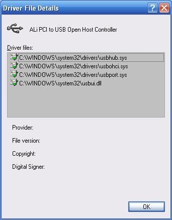

    Do you have a 'Standard Enhanced PCI to USB Host Controller' showing in Device Manager under your USB controllers? The 'Standard Enhanced' part indicates a USB 2.0 controller. Though it would still work with a USB 1.1, just slower. I don't have a USB 2 controller in my XP computer and my other computer is running Vista, so your drivers don't match anyway. This is from USB 1.1. Since USB 2.0 is a add on, you might try installing fresh USB 2.0 drivers. Also, what's the drive letter for your external drive? I would make it a letter closer to the end of the alphabet so it has no chance of messing with your existing drive letter assignments.
    Redwudz,these are the USB controllers I have:
    I have XP SP2 so the USB2 drivers are native to Windows XP, they were installed with SP2. The drive letter for the Lacie is "L", it comes right after the "K" which is assigned to a removable disk (an external USB2 card reader).How do you change the drive letter of the Lacie if it is not recognized in the first place?

    The drive letters may be a long shot, but I tried changing one of my external drives to no letter and it disappeared from explorer, but it still showed up in Device Manager and Disk Management. I also added a memory card reader and it used up five of my drive letters, knocking one of my drives out of explorer.
    You have a 'Enhanced controller' for USB 2.0, so that should be OK.
    I agree, it's likely a software issue, but where? Is it in the drivers or something in the OS code that's messed up. I would try replacing the drivers, though.

  12. I tested connecting the Lacie to the PC using the FW400 interface. windows assigned it the letter "L", so I went to Disk Management and changed the letter to "Z". All went fine. I then disconnected the Lacie and reconnected it using the USB2 but no success, drive not picked up by device Manager, Disk management or My Computer. So I guess I will proceeed with the Safe Mode cleanup. I'll keep you posted.
  13. Well, I perfomed a safe mode USB cleanup and now the Lacie is normally recognized by the PC using the USB2 interface. One question though. I did the safe mode cleanup following the steps in this link: http://tinyurl.com/2fwb , but after restarting in standard mode Windows reinstalled the USB drivers by itself automatically, it did not prompt for the Windows OS Installation CD as the link instructions said so...?

    Then it's using your installed drivers from your HDD. They may have been corrupted or modified in some way by one of your programs. If they re-installed and it's all working, then all is good.
  15. redwudz, yes, I was only wondering how come the problem was solved using the same files already in my PC Windows installation and not being refreshed by non corrupted files from the Windows CD. Anyway, I changed the drive letter of the Lacie from "Z" back to "L" and all is working fine. Also, the Seagate external is also connecting normally as before, with the letter "F". Thanks everyone for the hints.
