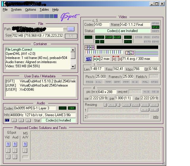

Here is a G-Spot Picture of the Videos I am using...

It's a PAL video. I am assuming you have converted it to NTSC to make it work on your PS2, and this will make it jerky.
FAVC might do a better job because it uses the Pulldown method for conversion.
It is also difficult, from your description, to determine if this is in fact poor conversion, or a media problem. If the movie is actually stopping and starting, I would suspect media. The PS2 is a very average player, and very intolerant of a lot of media. If the jeriness is just jerkiness in the image during pans and zooms, then it is a conversion problem, and I would suggest FAVC as a possible answer.Read my blog here.
